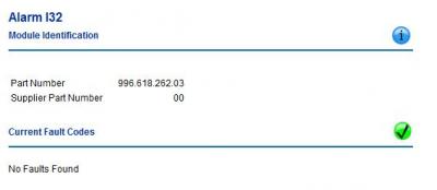

Durametric or Porsche PS2 or PIWIS will tell you exactly where the fault(s) are.
There is a lot of work (and cost) with guessing.
That is part of my problem.  I am attaching my Durametric Alarm report.  No faults at all.

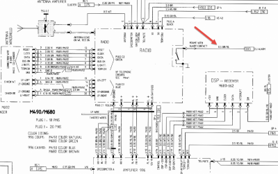

I have replaced the stereo and now get a single beep when I lock the car.
A single beep signifies an open zone - so that is likely your aftermarket radio.
If you had a CDR220 prior to replacement you will need to remove and tape the brown wire with the blue stripe.
Thanks. Could that be a contributor to my issue?
Yes, depending on whether the aftermarket radio is sending a signal on that wire.
Either way it is best to disconnect that wire and tape it.
Your are talking about this wire, correct?
Brown/Blue - Common Audio Ground - Yellow Connector C " Pin 3
I need to remove that from the connector and tape it?
Thanks, John
