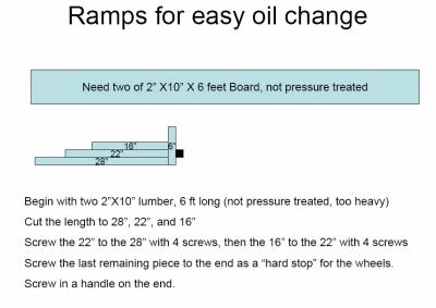

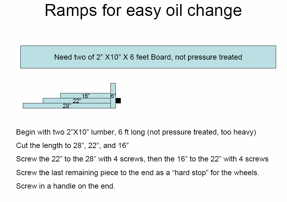

I built these ramps and have been using them for some time for oil changes, muffler changes, O2 sensor changes, etc. Can not remember where the idea came from, but it was not mine.
They have worked well for me and I have had some requests for sizes, so here it is.
As with any such item, this is a suggestion and using it is entirely at your own risk. Make sure the car does not roll forward if you back into the ramps.
Ramps_for_easy_oil_change.pdf

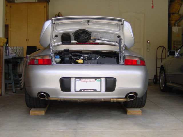

What was that about great minds think alike....
Actually, a friend of mine was asking how far back to drive to get the tires on fully, and the idea about using the "waste" piece of wood was borned. I can open my door and look for position, but with the stop is less contortion to the aging spine.
