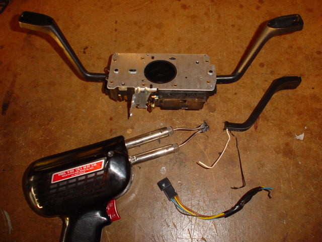

Some time ago I had cut off the cruise control stalk from a 3 stalk assembly, for a track car as the guy did not want the cruise control stalk in the way. I had saved the cutoff stalk and ended up giving it to Richard.

You can test the switch on the end of the stalk. I just did it with an ohm meter and an extra 4 stalk switch assembly I have.
With a thin blade you pry on the end of the end of the cover and the cover pops off. You will see a white and black wire going to the switch. The switch is off when it sticks out and on when it is pushed in. I got a closed circuit reading on my meter when I pressed the switch in. The wires are very close together so make sure your meter probes are not touching each other.
The only reason I asked it you had the 4 stalk was in case you had a bad cruise control switch and had to replace the entire assembly. Someone would want an old 4 stalk unit in order to get the OBC stalk for an OBC retrofit.

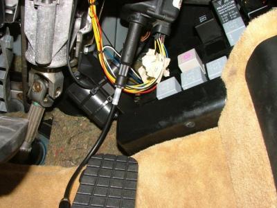

Today I was finally able to locate a control unit from a dismantler ($200), which motivated me to get the old one out and look at it. Not so easy to get out, but if it helps somebody in the future, here's the steps I took:
1) Remove the duct that runs transversely from the HVAC unit to the left side of the footwell.
2) Remove the visible screw in the remaining duct to the HVAC and pull it aside to observe the controller.
3) There are three 10 mm bolts holding the control unit to key-slotted holes in the brake pedal bracket. Loosen the top two 1/2 turn or less and leave them in place. (These are the harder two to access). Remove the third bolt entirely. I found that I could not remove the unit with this bolt in place as it made it too difficult to get sufficient clearance to pull out the controller.
4) Pull the entire controller (still attached to the throttle pedal) down.
5) The electronic control unit is held to the controller by four phillips head screws at its corners.
Of course, the part number on my unit (996-617-021-04) is not the same as the one the dismantler has (996-618-051-02). First question: Does anyone out there know if the dismantler's part will work on my '98?
