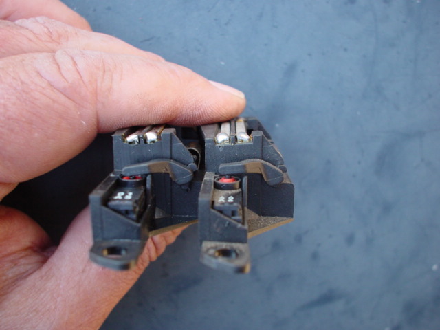

I wanted to share the problem I've had for the last several months and the resolution I finally found today. Like a lot of 986 owners, I've been having an intermittent problem where my top will not go down. The problem seemed to revolve around the temperature. I live in St Louis where the temperatures are frequently over 100 F in July and August. What I was able to do is to point the AC vents up so that they were directed to the latch assembly. After 10 to 15 min. of driving, I could pull over and the top would go down normally. I finally had time today to pull the switches and see what was going on. I used a multi-meter to test the continuity of the switches. I knew the swich that controls the drop of the windows (the one on the left side of the assembly with the large plunger that extends out when the latch is opem) was fine. The windows always drop immediately when the top is unlatched. I suspected that the switch on the right (the one that activates the top relay) was bad or sticking. Visually, the switch looked to be woking fine the pin operated smoothly. I tested the terminals on the switch itself and it showed that the switch was working fine. I then tested it on the lead that run across the back of the assembly to the plug. There was continuity there also. I did notice some corrosion around the solder joints were the leads attach to the plug. While cleaning the corrosion, I noticed that one of the leads had broken free of the solder. What was happening is that when the lead would get hot, it would curl slightly lifting off the terminal. When it would cool down, it would uncurl and come in contact with the terminal allowing the connection to be made and the top to operate. I cleaned the corrosion and resoldered the lead (the white arrow in the picture points to the contact I had to resolder. I checked for continuity at the plug and I had connection. I reinstalled the switch and the latch catch and everything is working normally again. I hope this helps someonelse.
Now you tell me. I replaced the switch in December. But I did not have the same problem. I'll take a look at the old switch to see if I can bring it back to life.

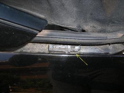

Also what are those 2 things just next to the back/roof drain pipes. It has 2 wires coming out, are these some switchis too? Could that be a problem?
Dried the water out of the railing where those two thingies and roof works now :)
I'll bury it under the grease, that should stop the water short cutting the circuit.

and now the picture :)
This is the part, but I'm not sure if it is electrical or not.
If it is not :( then the problem must be somewhere else, so please, tell me these are some kind of switches :)

Velryba,
The part in your picture is an adjustment for the clam shell. If you press it together, it's taller so the front edges of the clam shell will be lifted. You use these to level the front corners of the clam shell so that they are even with the body of the car when the clam shell is closed.
Your issue sounds like it could be a combination of thing. 1. Get the drains cleared. The standing water could cause all kinds of electrical shorts, not to mention rust and corrosion. 2. Replace the relays.

after i suspected the latch microswitch, i openned the cover and inspected the switch. actually, technically there are 2 micrswitches within the swich (i think you mentioned that). one is red, it get depressed first after a mm or so when the hook first enter the latch. the second one is black, that gets depressed when the hook is all the way inside the latch.
i am able to stop the windows from going up by sticking a piece of soft plastic into the latch. i tried a smaller piece just to get the first click (the red microswitch) but that did not work. i had to use a bigger piece of plastic so that i hear the second click (the black microswitch), that stops the windows immediately.
i touched the 2 metal strips and the 4 soldering joints, i did not see any looseness. i did see some varnish like deposit on the soldering join you mentioned in you thread.

I don't think the problem your having would be with the top micro switches because the windows are going all the way down. The first switch, when activated, only drops the windows far enough to allow the top to open.
My thought would be that you have a short in the switch in your drivers door. The key lock in the door has a switch that allows you to raise of lowwer the windows from outside the car.
If you turn the key counter-clockwise to unlock the doors and hold it a few seconds, the windows will go down.
If you turn the key clockwise to lock the doors and hold it a few seconds the windows will go up.
That's the switch I would check out.
I think that by inserting somthing into the latch your over riding the command sent by the door switch causing the windows to stop. Kind of like if you press the window switch once to start the auto down then press it again and the window stops.
Dan
