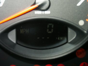

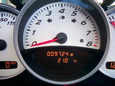

If you have the OBC as an option or did the retrofit send me pictures of all the displays you see as you move the lever or push on the switch. Also take pictures of the entire cluster that shows all the analog gauges.
When the UK guys started doing the OBC retrofit I was suprised at the pictures. UK is a metric country. This is Grant's new style cluster - I think a 2003 - that he did the retrofit on. The analog speedo is miles. The digital speedo is miles but that you can change with the knob. The odometer is in miles. But the temp display is celsius.

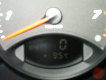

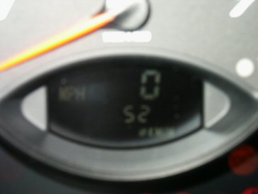

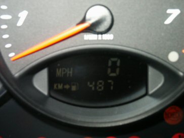

Here are my pics. Some are a little defocused (I guess I was too close). I have the same units that you describe for the UK guys. They are also a little faint (since the top is DOWN!!! - Finally a warm day in Colorado)
post-17538-1173042329.jpgpost-17538-1173042336.jpgpost-17538-1173042342.jpgpost-17538-1173042350.jpgpost-17538-1173042357.jpg
Edited by rockymount1
Your analog speedometer reads in miles but the water temp gauge is metric. I don't remember the other 1999 Canadian car being like that. The 1999 owners manual I have shows KP/H on the speedometer for a Canadian car.

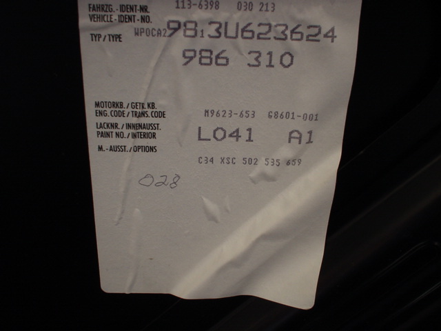

Option sticker (I assume you mean the one under the front hood) 139, 340, 502, 535, 550, 551, 584, 696.
I know that 535 is the Alarm, 550 is the Hardtop (which wasn't sold with the car), 551 is the Windstop, 696 is the Radio with CD. All the others, I have no idea.

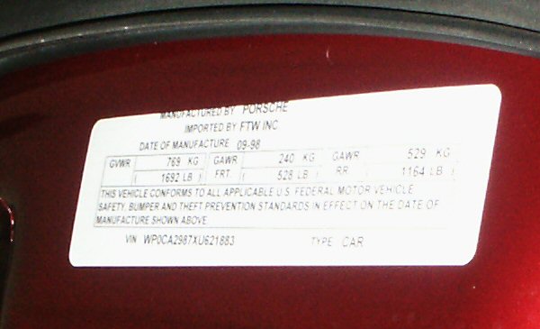

I don't know what you mean by the black sticker on the door. There is a black and white sticker that states the car was imported by FMC, inc. Also, the sticker states the car meets all US Federal standard at time of build. I do know the car was first purchased in Vancover per Carfax.
Finally, I do have daytime driving lights but I haven't looked at the fuse box to see if the relays are present or someone just did the hack.

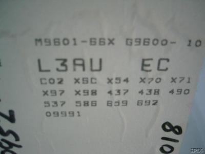

The country codes start with the letter C. This one is C02 for the US.
This is the black sticker on the door.
Here is what I find on my car. One is under the front hood and the other on drivers door. Am I looking in the wrong place?
Hard to read the white door sticker but looks like it says imported by FTW INC. I take it that is the company that imported it to the US and/or the company that Federalize the car. Never imported a car so I don't know

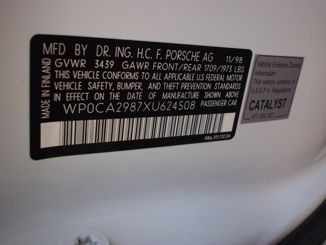

You should have a black sticker but maybe it is covered by the white sticker, or maybe the black sticker was removed by the importer. First pic is the black sticker on the drivers door for a 1999 US car. This sticker is put on by Porsche since Porsche certifies that it meets the standards of the country where it is being sold. I think an importer makes it's own certification.
Your option sticker does not have a country code. I don't see a C followed by 2 numbers. The plot thickens. Still trying to figure out why your analog speedometer is in miles. You can buy a kit and replace the gauge faces but then why is the water temp metric.
As an example, the second picture is a car from Mexico that came up to California to visit his local Boxster friend, and they both went to a local tech session that I also attended. I took a picture of the option sticker at the tech session because I had never seen a Boxster with Mexican specs. This sticker has C34 which is the country code for Mexico. The third picture is the metric instrument cluster.
