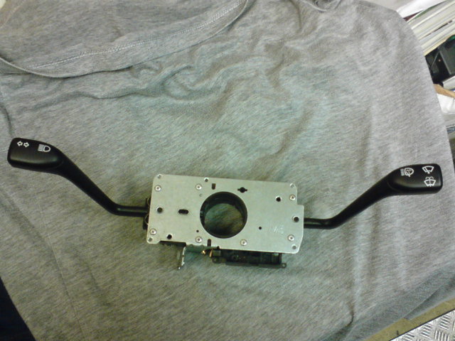

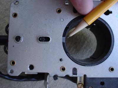

When you move the stalk up or down this black plastic thing sticks out.
When you make a turn there is another thing that pushes the thing back in and the stalk goes back to the middle.
Having the stalk return to the middle position is mechanical.
Got to find a name for those things. In the first picture I have move the stalk from the middle position which causes the thing to stick out. In the second picture the stalk is in the middle position and the thing no longer sticks out. If that thing is broken then it will not cancel.
Is your problem that the stalk will not physically return to the middle?

When you turn the steering wheel this thing on the air bag spiral/contact spring pushes the thing that sticks out.
There are a lot of plastic parts that you cannot see until you remove the steering wheel and all the stuff under it.
If you want to give it a go then search on the board for messages like OBC or trip computer. We remove the steering colum switch assembly when we do an OBC retrofit. You might check with someone who has done the retrofit and see if you can use their old switch assembly.
It is probably that plastic "flag" that broke off. It cancels the turn signal when you center the wheel. BTW, try not to hold down the turn signal when it's trying to cancel. It clicks "hard" and just feels like it might lead to premature breakage if done too much.
