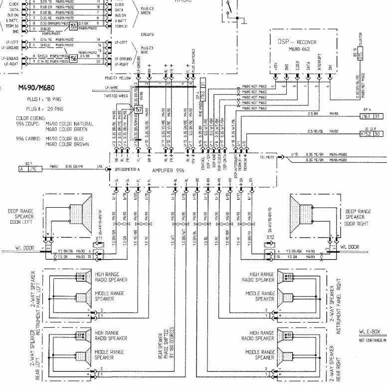

I thought this would be easy to find, but im having no luck ;). I need to find the pin-out diagram for the haes 996 cab amplifier. I'm trying to install a rockford 3sixty and i need to know which wires are source wires. Any help would be GREATLY appreciated!!!

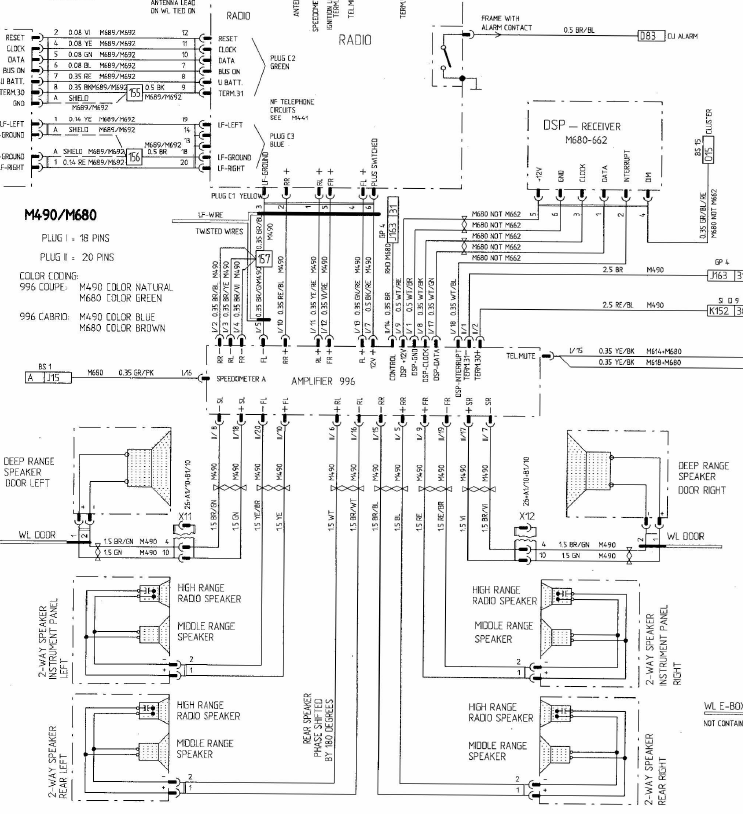

Hi Guys, I'm also trying to wire a new amp (audison) in place of the original HAES 4x40W (986.645.323.00). The diagrams posted seem to describe the 20-pin connector in detail but not the smaller 18-pin that is also on the amp. Any chance someone can post this detail? It would be GREATLY appreciated!!!!
I have a 2001 Boxster S.
Many thanks,
-randy
rboutin:
