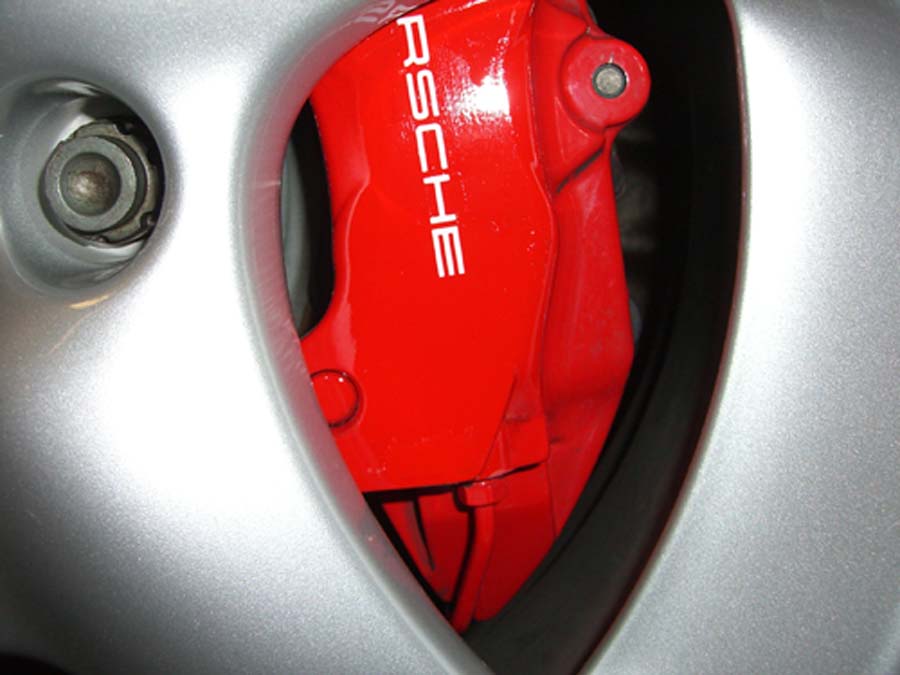

here's some pics...lesson learned is that the clear coat is applied to the powder coat and can be easily repaired

Doug, that looks great.
What exactly did you do to them? A simple wetsand?
I would really love it if you could do a quick write-up of how to do that.

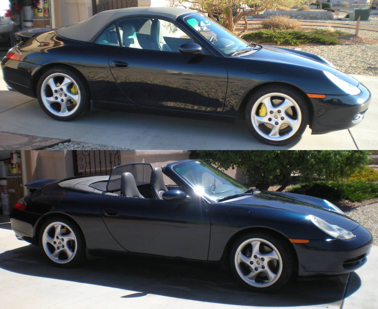

After reading and doing some research, I decided to paint my calipers from black to a nice sharp yellow. Buying yellow calipers are pretty costly, and my current calipers are still pretty good. The task was pretty easy and done in a few hours. I thought I would share the before and after pictures. One thing to note, I recently replaced my front rotors, which were not painted. I slapped them on the car and in a couple of short months, they were rusted. So anyone who buys unpainted rotors, I highly recommend either getting them already painted, or buy a high-heat / caliper paint (or caliper paint kit @$38) and paint them yourself.
Here are a couple of before and after pictures. The PORSCHE lettering on the calipers were sanded off to allow for a more smooth surface. I ordered a set of decals from Ebay for less than $10. When they get here, they'll be added.
The final product on the car. I chose the yellow as a nice contrast to the blue and my wife didn't care for the red. You can definitely see the yellow over the black.

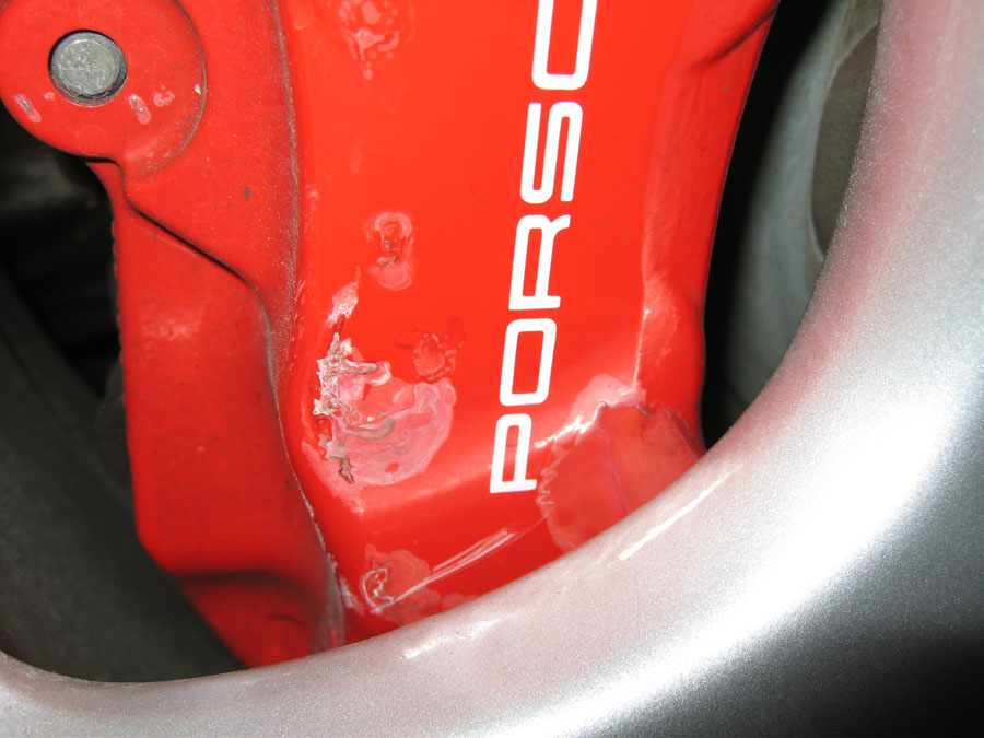

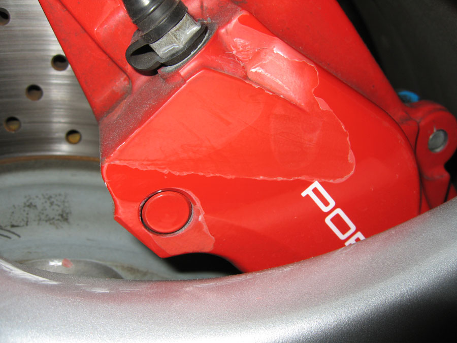

Hey guys, my calipers are shot and the paint has rubbed off on some corners. Do you know what the exact paint color or code is for Porsche Red calipers. Also maybe there is a paint manufacturer that matches pretty well I can just buy it off the shelf somewhere? I am thinking about painting them just as you guys have but want to match the factory red color as best as possible.
