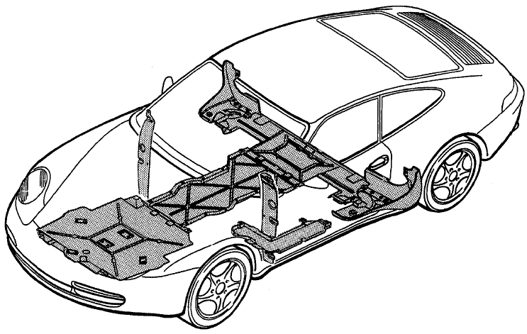

The Transmission oil change instructions come from the Porsche Service Manual so perhaps some of the early cars had these covers.
Sounds like everything is there...
Underbody Covers (current cars)
So what you are asying is that early 1999 & very early 2000 models may have had these plates; however it does not mean that mine as a later 2000 build or subsequent models may have these plates.
Thanks for clearing that up.
The attached photo mirrors the setup i currently have........ok I have more faith in my dealer service now.

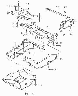

Loren,
Do you know where I can find the part numbers for the rear most panels? Specifically, the long skinny panel that extends across the car from just in front of the rear tires?
Also, the square panel that intersects that one?
Loren,
C2 or C4?
and item numbers from below
