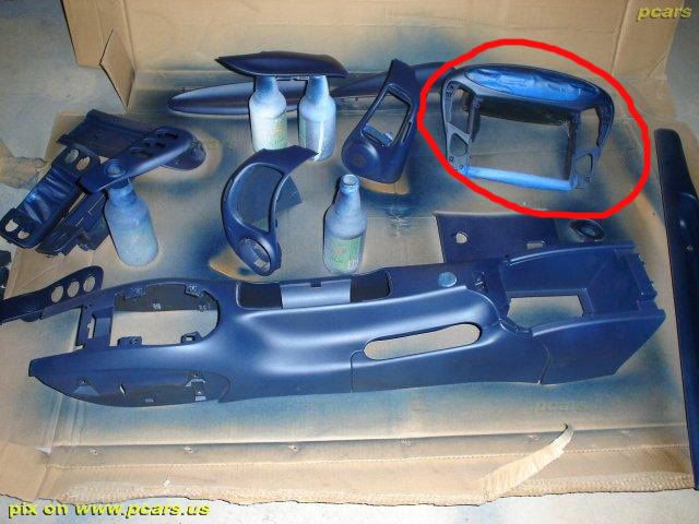

how did you remove the plastic trims highlighted in the pic? also why did you left the speaker grille unpainted? was it because they are harder to access or just preference?
i know the answer because i already asked him. ;) he sprayed those dash trim pieces while they were installed in the car. brave man! :o ;)

To free this highlighted piece, does it require removing of the climate control and stereo units? I can see 4 screws there holding both units to it.
