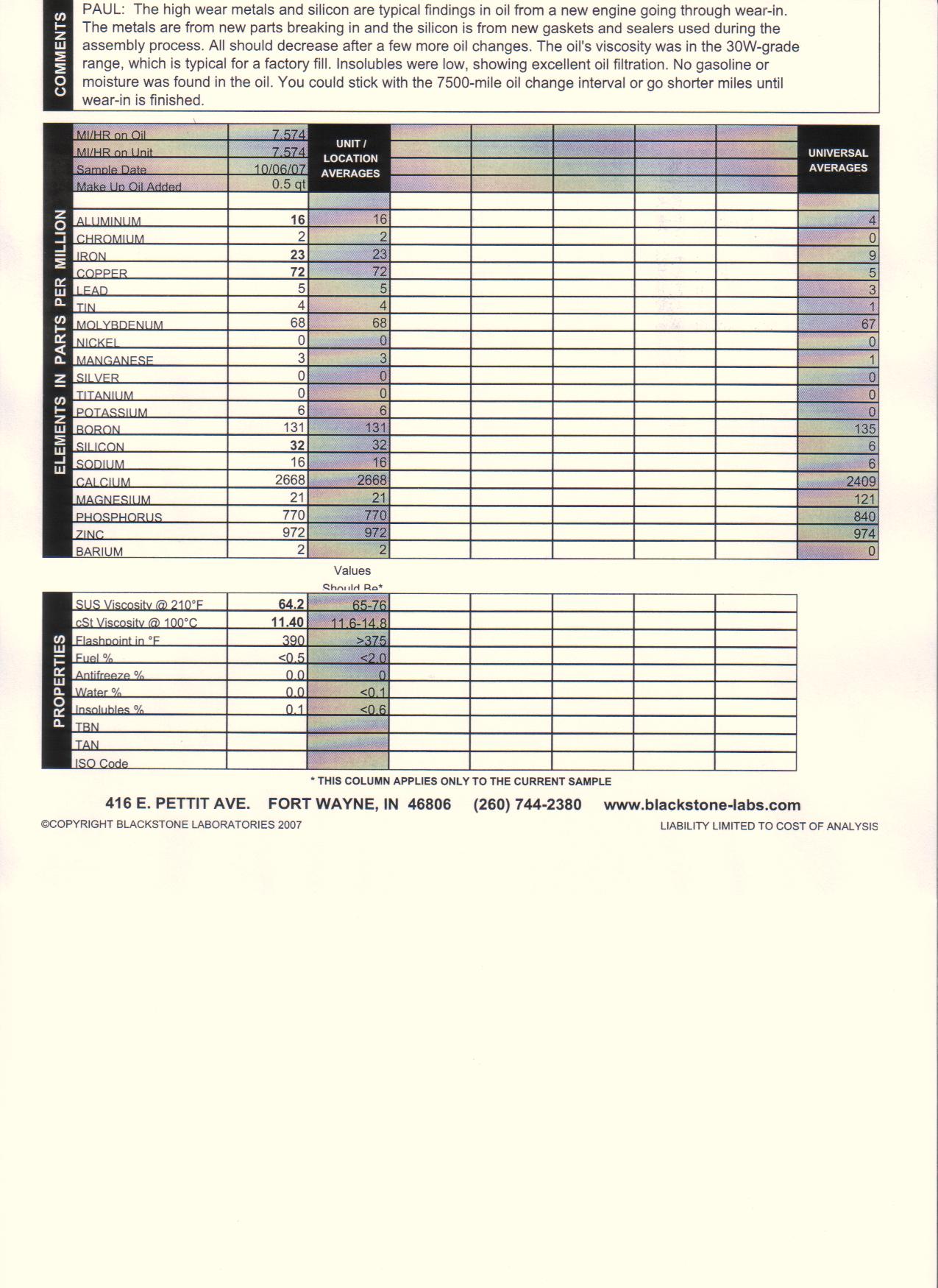

used oil analysis - 07 Box S, 7574 miles
Paulv, will you do this for every oil change?
Yes I will and I'll develop a spreadsheet to graphically trend the data. I've done this before for other cars I've owned.
Boggtown: the basic analysis from Blackstone is $22.50 -- I usually send it priority mail which is another ~ $4. When you take a sample, collect it when the oil is about half way draining.

Paul - the viscosity at 100C is shown as 11.4 cSt which is quite a bit down on the Mobil 1 spec sheet of 14.3 cSt. From your past experience, is this typical?
Richard,
Good point. When I filled out the sample form for Blackstone, I indicated M1 0W-40 because I assumed that it was the factory fill. From the narrative on the top of the analysis, Blackstone said that factory fills are in a 30 weight grade range, so this is why the KV100 value wasn't in the SAE J300 required 12.5 - 16.3 cSt range.
If this isn't true, and Blackstone and I are both wrong, then the oil sheared down like crazy.
Richard,

Considering that the kinematic viscosity was out of spec at only 7500 miles, I wouldn't wait 2 years or 30000km to change the oil!!! Once a year or 10000 miles is a good oil change interval -- Mercedes recommends this for all their AMG motors and 13000 miles for all other models, and when I had an 03 E320 prior to my Box, I changed the oil when the inboard computer said so (approx 15000 miles) and the TBN value was at 2.6. I don't know for a fact, but I would speculate that the TBN would fall dangerously below 2.0 when hitting 20000 miles.
If you're leasing your car, I would stay with the factory recommendation, but if you own the car and want to keep it for a while, go with 7500 mile but not more than 10000 mile intervals -- my opinion.
