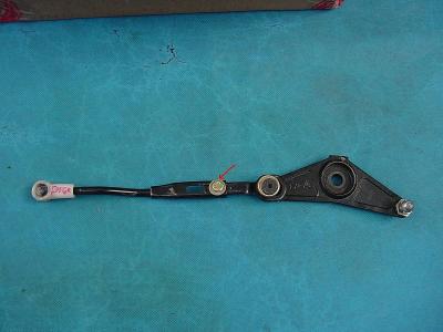

Will and Honda:
If I read your posts correctly, I believe that you are not making the correct adjustments.
In order to adjust how the front edge of the canvas top lines up with the top edge of the windshield frame so that the two tongues on the front edge of the canvas top can easily be guided into the two receptacles on the top edge of the windshield frame, you must make an adjustment at the push rods (or "joint arms") that are attached to the forwardmost part of the V-levers (when the top is almost closed).
The easiest way to access the nut that you must loosen is to open the top about 12 to 18 inches and reach under the rear of the convertible top frame bow.
Here is a photo of the push rod, with the red arrow pointing to the nut that must be loosened. The V-lever and the subject push rod have been removed from the car for this photo: post-6627-1195360269_thumb.jpg
You must loosen the 10mm nut (with the thick washer) that holds the two sections of each pushrod (one on passenger's side and one on driver's side), and then loosen or shorten the overall length of the pushrod so as to get the correct engagement at the front windshiled frame receptacles.
The longer you make the overall length of the pushrod, the closer that side of the front of the canvas top will be to the top of the windshield frame. The shorter the length of the pushrod, the further away that side of the front of the canvas top will end up when the top has reached its forwardmost travel.
Maurice, thank you! That is indeed what I needed to do. Five minutes resolved the latching issue!!!
Honda:
Good job! Let's hope Will has the same success.

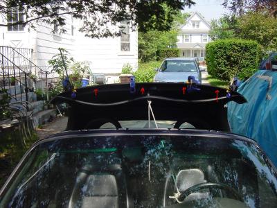

Honda:
To have the best chance to "take out" the wrinkles shown at the front edges of your top in your photos above, you are going to have to "unpeel" the front of the top again. I am going to assume you already know how to do that if you have already removed and installed the top yourself. (If not, let me know).
Once the front edge of the top is peeled back, you first have to clean away any glue or double sided tape residue that is there so that you have a completely clean surface. You can use denatured alcohol for that purpose, it works well and the new double sided tape will stick on that much better.
Once that surface is cleaned, apply two sided tape in the channel between the two ridges that run from left to right across the entire metal rib. I used 3M automotive double sided tape, Item #06384 available at any auto paint store.
The front edge of the canvas top will have a leather or cardboard strip to help you line it up parallel and tight. Stretch the canvas top by pulling it forward, wrap it around the metal rib and press it onto the double sided tape that you just applied. The adhesive will hold it in place but I also used a couple plastic spring wood clamps to pinch it in place so I can walk around and make sure it was even and straight.
Now, this is the crucial part for getting rid of the wrinkles: To line up this part of the front edge correctly, make sure that the leather or cardboard strip lays in between the two slight metal ridges that run from left to right, and that it lines up snug against the rearmost of the two ridges when you are gluing/clamping that part of the canvas top. Work from the center out to each side. When you get to right and left corners, make sure that you pull hard on the canvas so that it is tightly wrapped around the front of the metal rib before you wrap the very corner of the canvas top (with the small indented cutout to allow the screw to go through) around and fasten it with that one screw (after you next install the weatherstrip gasket over it).
Here is a photo showing the method of holding the canvas in place as you are lining it up (click on the photo to blow it up):
The red arrows show the area under which the two ridges are and the clamps used to hold the canvas against the double sided adhesive tape. Note that the front weather strip gasket has been temporarily attached at the right and left corners with one screw in each corner.
If you do the repair, please post photos or questions with any difficulty you may encounter.
Also, if you do this successfully and you feel up to tackling the wrinkles at the rear, we'll give that a shot too.
Good luck!
