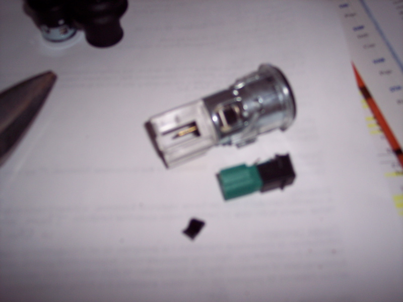

The parts that need to be purchased are:
99665210210 (list $18.18)
99665210110A05 (list $10.20)
I couldn't get the old one out easily without frustration and since I wasn't going to use it again I decided to just break off the offending piece (pic attached of black and green piece removed with wire cutters) so the old assembly would just slide out :)

Just did this and breaking off the black and green pieces from the old unit is definitely the way to go. That makes it a 5 minute job.
