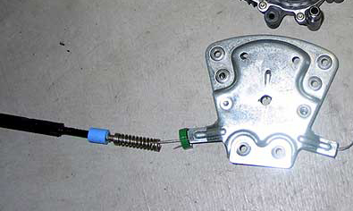

I had the same problem with my window regulator. The reason that slack is created in the cable is because of the inadequate blue plastic piece that breaks! From the outside this piece looks like it is about a 1/2 inch long and holds the cable sheath in place. In actuality, this piece has a tube piece that extends down the spring and into the pulley. What happens is the tube piece breaks off and slides into the pulley (possibly causing a grinding noise and start the fraying of your cable) and the cable sheath slips through the hole of the plastic piece and thus creates the slack in the cable. I actually took my regulator apart and reattached the plastic pieces using marinetex and it's as good as new. Probably better because the marinetex is stronger than plastic so I don't expect it to break again!

Ross, in your picture is that a before pix?

Maurice and Ross, thanks for the info.

I got that picture off an already posted DIY for the window regulator! I didn't have a camera with me when I was doing the repair, so I don't have any pictures. Based on what I know, that picture is of a broken plastic piece. The cable is loose because they have disassemble the regulator. If you could zoom in you would see that the tube part of the plastic is not attached to the bigger piece any more. It is probably inside the pulley housing. The tube acts as a guide as the spring compresses and uncompresses. Once the tube breaks off, the cable slips through the plastic piece and creates the slack that prevents your window from going down. If you are not mechanical, I would suggest just getting a new regulator! The hardest part of the repair was putting the cabling back together. You also don't want to use just a simple 2 part epoxy. I suggest the marinetex that I used. It's tough!! You can get it at your local boat shop or maybe even Walmart. It's used to repair boat hulls.
