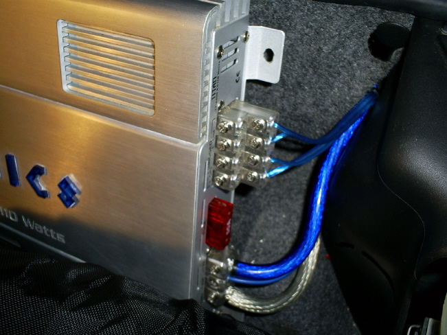

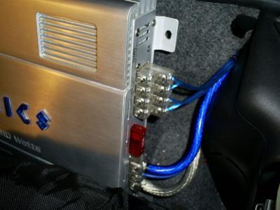

I started with the speakers first. I put Focal 100KP's in the dash, these are component speakers with 4.25 mids and tweeters, they fit with minimal modifications, just cut the old speakers out of the frames and used this frame to secure the mids in place on the grills. the tweeters were held in place with silicone, I think I used a dremel tool a little bit where th tweeters mount, and to cut the frames of the old mids. for the doors I started with a pair of 5.25 mids striped out of a set of Focal 130KP's. they were OK, but not a true sub. They fit in with just a little work with a dremel tools, had to remove some of the reinforcing ribs in the speaker enclosure as the new speakers were deeper and wider at the back.
Ran these with the stock amp and the amp/ohms worked fine. the sound was much better than stock, totally improved. Later I swtiched out the doors for a pair of Focal 5WS, a true sub, but no loner made, Focal now has 13KP and one other 5.25" sub. the true subs were a big improvement over the Mids I originally used. The next step was adding a JL Audio E6450 amp, this is a 6 channel amp, so I have two channels for the dash, tow channel for the rears, and two channels combined for the dor/subs. I also put focal 100CA's in the rear, not really necessary at the rears are only for infill, but it did make a big difference over the stock speakers which are the same as the stock dash speakers.
The new set up with the amp and speakers sounds fantastic, and you can really crank it with any distortion. Now with the small subs you won't ever get the type of base that shakes the whole car, but that is not my desire. some users put 6.5" in the doors, with a little more dremel work, or pur an enclosure in the back, with a cab there are boxes you can put in the rear seats or others that fit behind the front seats, and you can get an 8-10" sub in.
I am still using the stock head unit (CDR220) and the stock 6 disc changer, and the system sounds really good, although the CD sound better than the radio, either the in dash or the changer. I know a new head unit would be even better, but I like the stock look so I am sticking with the stock unit. GOOD LUCK!!

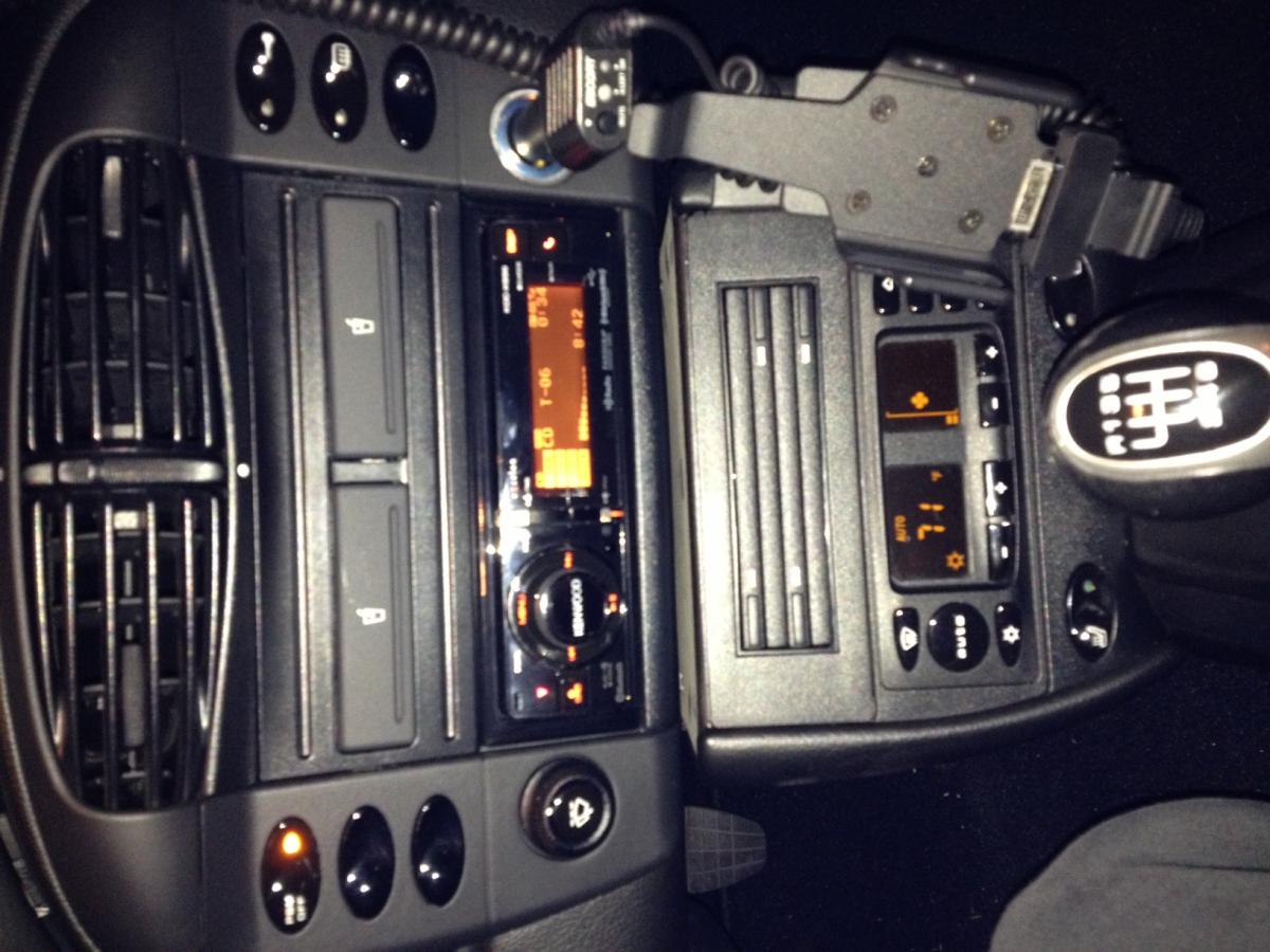

I recently acquired a 2001 C4 that came with the CDR-220 and hifi system with door speakers along with the stock 6x40 watt amp. As others have noted elsewhere, the system sounded like a cheap AM radio. In addition, I had gotten used to having a nav system and bluetooth hands free link in my cars, so an upgrade was inevitable. Given that the 996 cabin is not the ideal acoustic chamber, however, I didn't want to overdo it. I also wanted to do it myself, so I wanted to keep it simple.
Originally, I was planning to go with a Pioneer double din head unit with nav and bluetooth, along with new speakers. Realizing that my iphone 4s had nav, bluetooth and a multitude of other apps such as Pandora, I ultimately decided to go with a single din head unit that could take advantage of the tech in the phone.
I had previously purchased products from Crutchfield, which include installation instructions and the necessary wiring harness adaptors, so I started my search there. The Kenwood Excelon KDC-X996 had the features I was looking for (iphone integration, bluetooth hands free link, Pandora, HD radio, Sat radio etc.), and the model number matched the Porsche's, so I went with that one for $299. Installation with Crutchfield's instructions and wiring harnesses was straight forward. Based on others' advice, I ended up mounting the hands free mic in the top front corner of the driver's side headliner, routing the wire down the A pillar and under the dash. It looks and works great there.
I found a great way to mount the iphone itself at www.proclipusa.com. The mount attaches securely and unobtrusively to the passenger side of the front center console without having to drill any holes, and puts the iphone within easy reach to the right of the stick. Costs about $100 with tilt, swivel and pass through cable connector.
The head unit works great with the iphone. I now have the features I really wanted (nav and bluetooth), plus a lot of other nice features (including the ability to match the interior lighting colors) and extensive audio adjustments. The new head unit resulted in a significant improvement in the sound, but the stock paper cone speakers still left much to be desired.
I quickly discovered that getting aftermarket speakers to fit the stock dash and rear seat covers was non trivial due to the non standard mounting points. I didn't want a solution that involved butchering the old speakers and copious amounts of glue. I addition, I didn't want to invest the time required to fabricate my own mounting adaptors. No need to reinvent the wheel here: I found a vendor in the UK that makes an adaptor kit for certain aftermarket speakers, JM Garage. They also list these adaptors on ebay from time to time. The adaptor kit works for the dash and rear seat covers. The kits are a bit (i.e., very) pricey (about $90 per pair of speakers); but for me it was well worth the savings in time and effort.
I decided to go with the kits for US Alpine speakers (SPS-410 - less than $50/pair on Amazon). Installation with the adaptor kits was a breeze. The Alpine speakers are a tremendous bargain. For mids and highs, they sound fantastic in the 996. A huge upgrade over the stock speakers. As 4 inch speakers, however, they do not reproduce lower frequencies. Moreover, the hifi amp sends the lower frequencies to the 5.25 inch door speakers anyway.
Replacing the door speakers was, therefore, next. The good news: almost any standard 5.25 inch speaker will fit. The bad news, you have to take the door panels off to get to the speakers. There are good online tutorials here and elsewhere to get the door panels off. It turns out to be a relatively easy task.
Speaker selection for the doors is a matter of price and functionality. If you use the stock amp, you want a component speaker since the stock amp sends only lower frequencies to the door speakers. A lot of folks seem to like focal speakers. Given the high price, I'm sure they are great; but most installations that I saw online a used a lot of glue. I prefer to avoid glue.
After looking around for something with stock amp compatible power and the best low end frequency response, I decided to try the 5.25 inch speakers that come in the Pioneer TS-D1320C component set. The set runs about $90 and includes component tweeters and bulky crossovers, which I did not plan to use (unfortunately, I couldn't find the 5.25 inch speakers for sale by themselves). Selling points for me: "deep basket for better bass reproduction" and frequency response down to 35 Hz. Of course, the proof is in the pudding, and these speakers sound great. Very nice base response for a 5.25 inch speaker. They are not 10 inch subwoofers by any means, but you can definitely feel the base in the car, and it rounds out nicely the excellent sound produced by the Alpine speakers.
All told, I have a very respectable sound system with the technology add ons that I was looking for at a cost of $770 and a few hours of installation time. I wish the Kenwood had the speedometer based automatic volume control like the Becker, but nothing's perfect so I adjust the volume manually at highway speeds. I love my 996, and now I love its sound system too.
