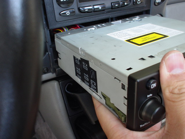

If you pull the head unit out and look to the left you will see the alarm contact. In my first picture you can see the dent the contact left in the plastic insulator.
With the oem radio the alarm contact cannot ground to the metal body of the radio because of the plastic insulator. But if someone tried to pull the radio out with the alarm on, the contact would touch the metal body of the radio and the alarm would go off.
So, you put a small piece of tape on your aftermarket radio in the area where the insulator would be. Needs to be sticky and thick or the tape will peel off or the contact will slice it when you slide the radio back in. That is the black tape in the picture of a TrafficPro. 2 layers of tape were used.
Or, you disconnect the wire to the contact and tape the end of the wire so it cannot touch anything metal.
Or, you leave it the way it is. The alarm still works and everything except the radio is protected. Some people like the single beep to tell them the alarm has been set.
