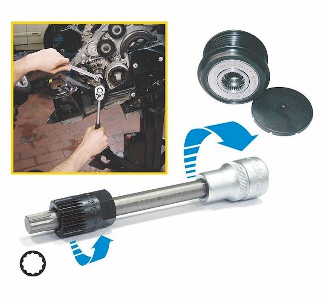

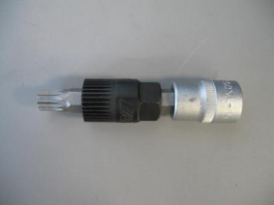

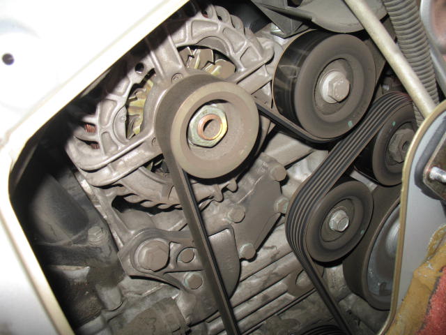

The first picture shows the freewheel pulley. The second shows a fixed pulley with a nut that needs to be removed to get the pulley off.

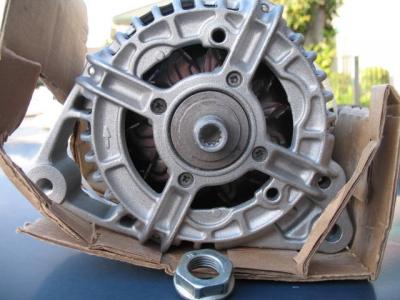

The third picture is a rebuilt alternator you can buy from any parts place. They sometimes do not come with a freewheel or any pulley. But if you have the correct tool you can remove your freewheel pulley and put it on the rebuilt.

I have not replaced one but I have the tools to do it. You should double check the shaft because I do not think it is a torx, but a 10 mm triple square/XZN. Count the number of splines. Torx is 6 splines. Triple square/XZN is 12 splines. You need the triple square bit to keep the alternator shaft from rotating while you remove the freewheel pulley, or if you have a fixed pulley to remove the nut for the pulley.
The black tool has 33 splines and a hole in the middle for the triple square bit. With the black tool you unscrew the freewheel pulley while keeping the alternator shaft from moving with the bit. You do not need the black tool if you have a fixed pulley.

First picture is the Hazet version of the tool(s) to remove the freewheel pulley to give you the idea how it works. I did not want to pay Hazet prices and I already had a 10 mm triple square bit, so I bought a Twain version of the black 33 spline tool for $8 from ebay.

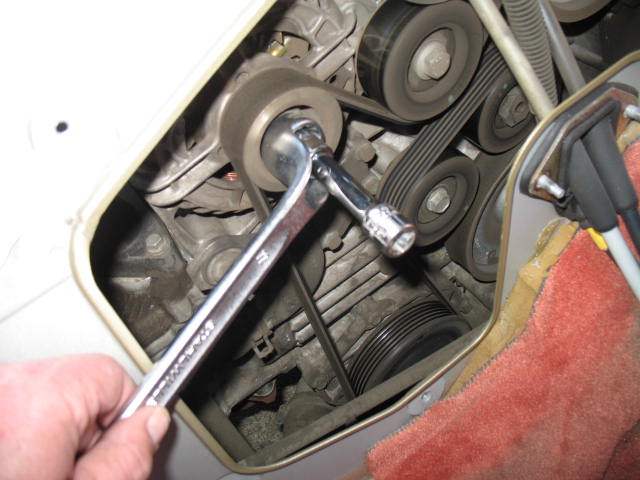

Second picture is for people with a fixed pulley. You need the 10 mm triple square bit, and a deep offset box end wrench to unscrew the pulley nut. On my car the nut is 24 mm.
I think you will find that it is actually easier to remove the freewheel pulley while the alternator is in the car..
