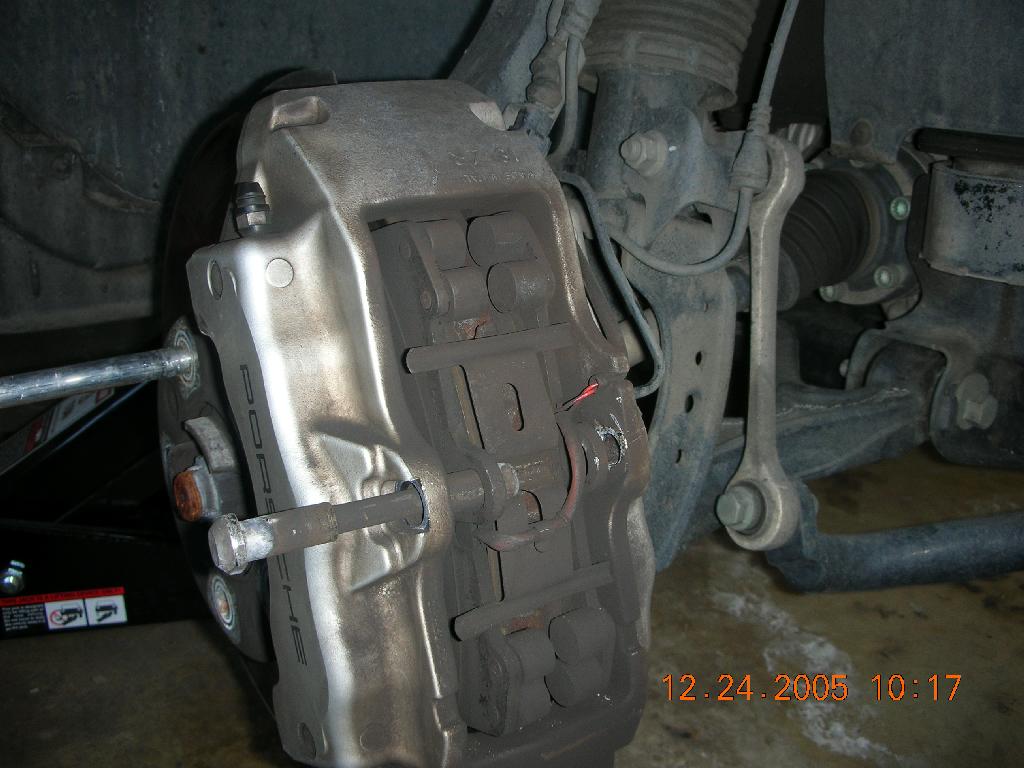

So my thinking was that I wanted to stay with OEM, since I assume Porshe has poured tons of manpower into choosing the best for their lineup (it's the same on all cars so I'm told...including carrera). They use Pagid pads and Zimmerman rotors. You may find others who have track experience that will give you track recomendations. I didn't go this route. I did just replace my rotors this weekend after doing a full brake job on the front. I have a Cayenne S and got the following from autohausaz for $413:
1 7L0698151J Brake Pad Set; Front; OE Compound
2 7L0907637 Brake Pad Wear Sensor; Front Left/Right
1 7L6615301K Brake Disc/Brake Rotor, Directional; Front Left; Vented 350x34mm
1 7L6615302K Brake Disc/Brake Rotor, Directional; Front Right; Vented 350x34mm
Much like you, I had to first check if the rotors were 17" (330) or 18" (350) and this was identified on the top of the caliper. You also need to buy the caliper removal bit (front was a torx-50). In hindsight I should have also replaced the caliper bolts because I had to tear up the bolt to get it off (it's 200lb tourqe). I didn't want to replace the rotors but I bought a caliper tool and I had 28% left after 33K miles. This wouldn't have lasted another pad set.
