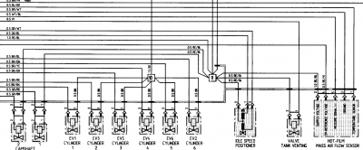

Mystery 1. When I went to disconnect the MAF sensor's wiring harness, I noticed that one of the five wires in the harness had been snipped completely off, with only about 1mm left inside the harness! See photo . There is no other trace of this wire remaining. Of all these mysteries, this one is the most troubling ... partially disabling the MAF sensor to allow more toxins into my catalytic converter?? Can anyone guess why this was done, and what effect it might have on the car's performance?

1. See the wiring diagram for the proper wiring colors for your MY1998 Boxster.

According to the diagram you posted, the snipped off wire is "MESSORE SIGNAL (+)" and it's a Bl/White wire that is missing. That's the number 5 contact for that wiring harness --- there are tiny numerals in the plastic, on both the male and female sides of the connection. All the other two-color wires match up in color and position.
I'll do some reading, studying and head-scratching to try to figure out what a "messore" [definitely does not say "message"] or "MESSDRE" is.

MESSORE SIGNAL (+) is the air flow (over the MAF) signal sent back to the DME.
So with no air flow signal you are likely not get good revs above 4500 RPM but idle is likely okay.
Hopefully the missing wire is in that harness and can be spliced into.
