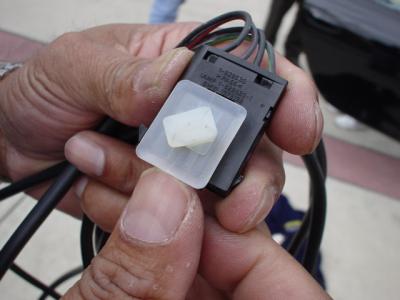

You have to get the white clip in the roll bar along with the electrical connector. Then you have to hook up the connector that comes from the speakers to that connector. Trying to do that when the top is not in the service postion........
A tip on your install. I have watched Raman put in several rear speaker kits and we filmed on of the installs. It is hard to install the white clip since you need to twist it so that it locks in position. Raman puts the clip on the connector first then twists the clip into position. This way you have leverage. It is the clip for the harness that runs from the box to the head/amp.

Thanks for the tip. It is indeed very difficult (yes, impossible) to attach that clip to the square hole in the rollbar, but that is true only when the top is fully up or fully down. If the top is partially open and the rear panel covering the seat belt is removed, it is no problem getting into that area from the front. I attached the clip and connected the harness with no difficulty, probably in 15 sec. You really don't have to put the top in the service position to get at the attachment point and make the harness connection.
