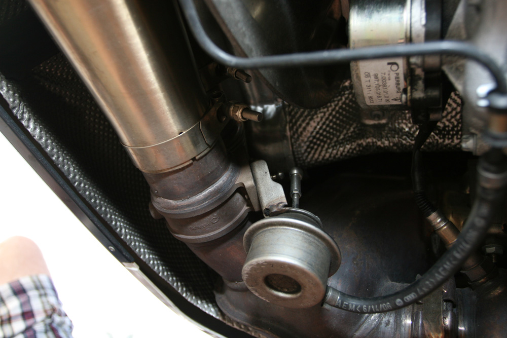

Well here's the culprit. Speed bump bent the actuator back. They sure didn't put these things in a very good spot.
