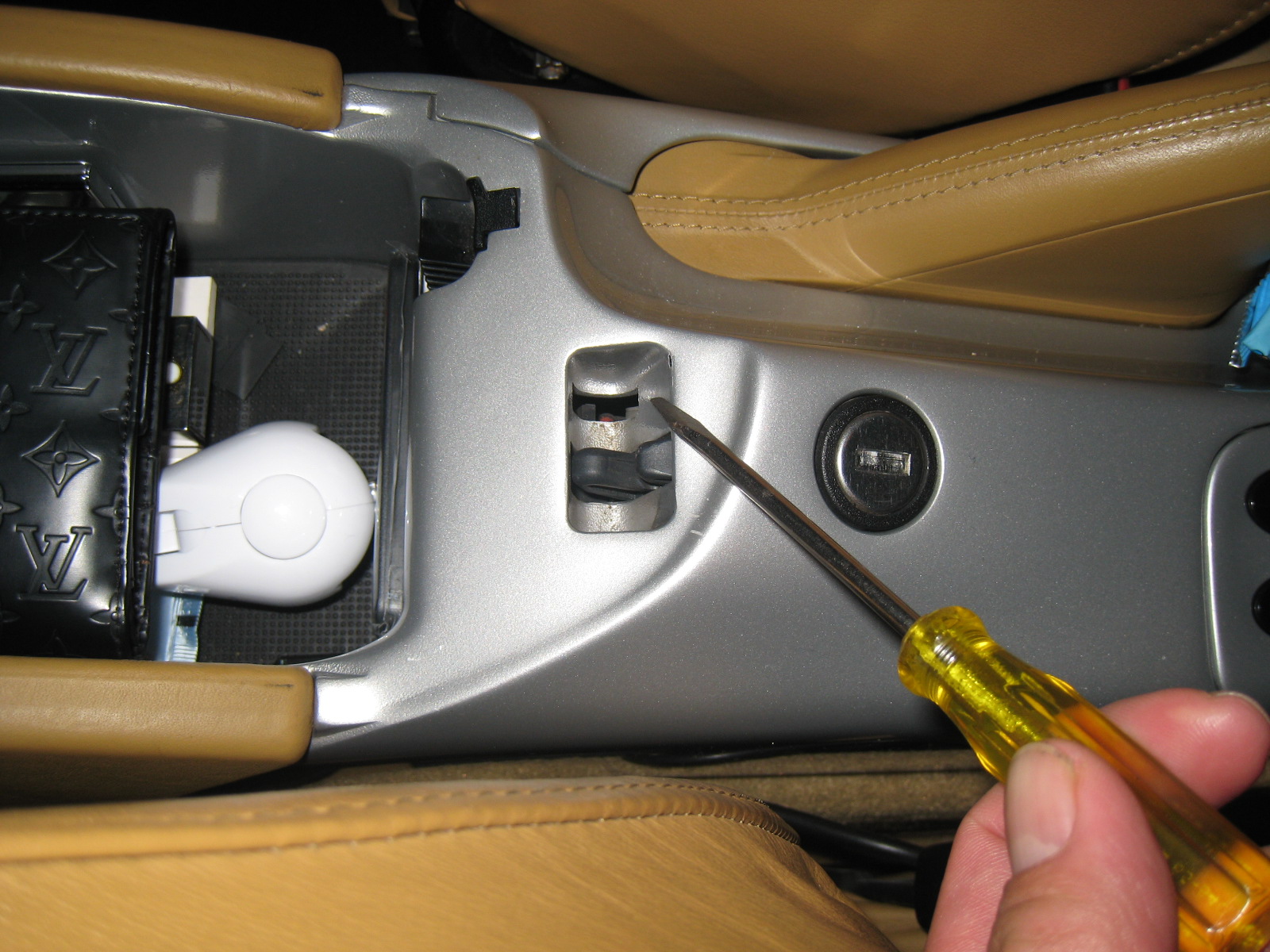

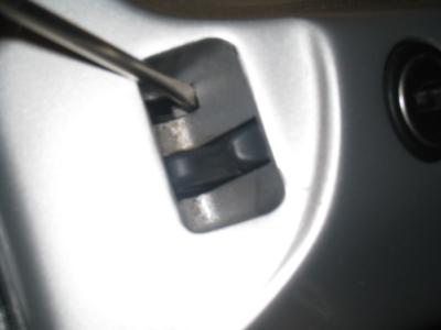

leave the centre console lid in open position, there's a metal spring thing on the passenger side of the 'lid catcher'. simply push that spring thing all the way in the direction towards front of the car, until it got stuck behind the plastic lining
this would disable the 'lid closure sensor' in a way, so you can fully close the lid and still get a 'horn' when remote lock the car.
I havnt experienced any trouble with this method.. so far :-) and it's totally reversible

I noticed that this only works if you leave the glove box open not the center console. Has anyone found the sensor for the glove box?

use a screwdriver to push the spring towards the front of the car until it's been caught by the plastic ... i hope i explained it clear enough
Thanks for the picture, this works great for the center console... takes about 5-10 seconds after locking for the horn to honk.
Great little hack! Thanks again! :lol:
