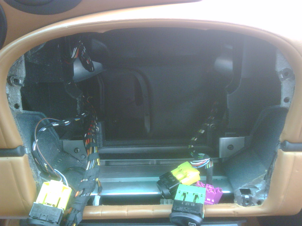

Wiring = 10 mins
Trim removal = 30 mins

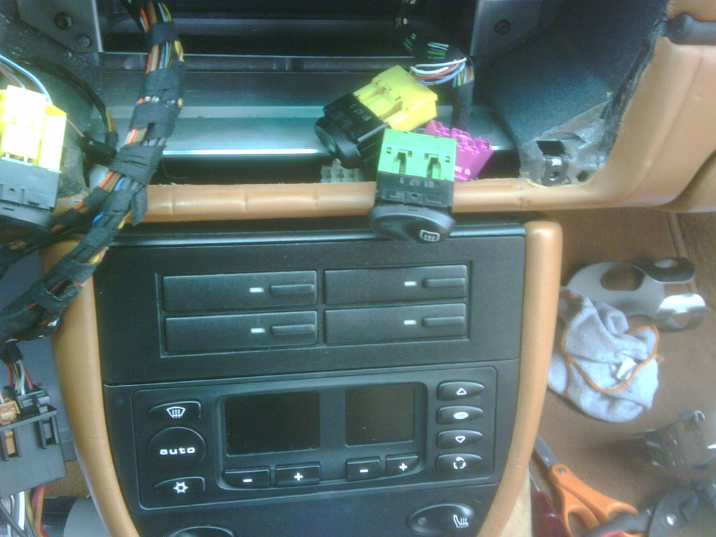

AC control module re routing = 30 mins
Microphone wiring = 5 mins

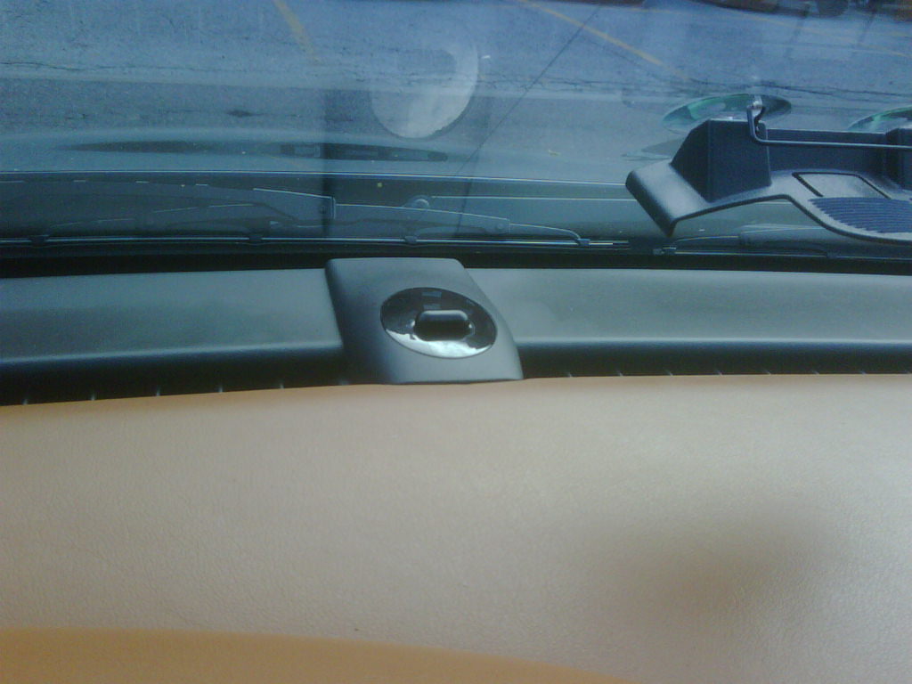

Nav antenna install = 15 mins
Installing cage, setter etc = 10 mins
Installing unit = 10 mins
Putting everything back = 30 mins
Putting on beautiful trim plate that came with this kit = 5 mins

A question: where did you put the nav antenna?

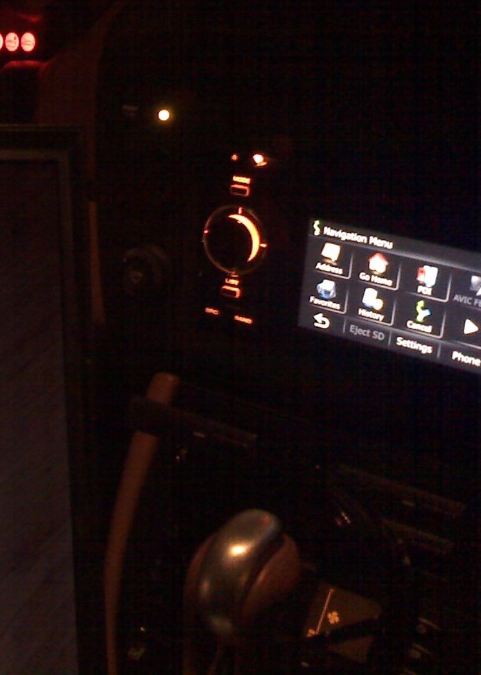

It can go where the OEM nav antenna is placed which is under the center cover where the dash meets the wind shield. 2nd picture down on the left hand side. Just behind the flasing red light (alarm) when alarm is activated.

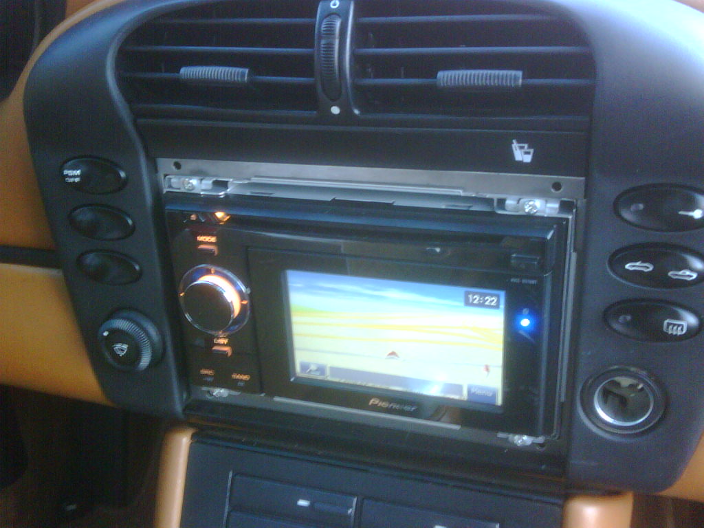

I bought the double din installation kit from Eurospeed Motors http://stores.ebay.com/Euromotorspeed
which came with the trim plate. May want to see if they will sell separately. I went with the Pioneer AVIC D-3 and also bought the bluetooth adapter. Photo of finished installation.
