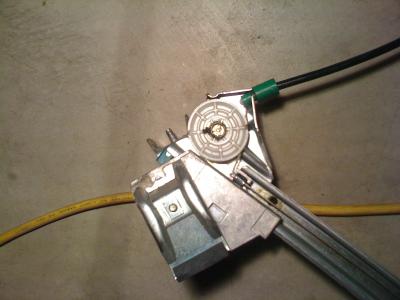

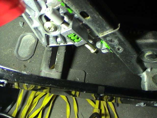

Well I spent Saturday morning changing my window regulator on the driver side, suprizingly it was not that hard, The tips I have are as follows. The Bombay digital link had more than enough info . to complete the job.
1. Roll the Window down before disconnecting the battery, if you are going to disconnect the battery; Standard operating procedure. You will need to reconnect the battery when it comes to the adjustment phase.
2. Be very careful not to damage the foam insulation when gaining access to the Window regulator. I resued mine by being careful ($75.00 part)
3. Mark the lower attach legs of the old regulator, will help when installing new part and require less adjusting.
4. Mark the Glass at the lower attach points, make sure its very visible befor you remove the galss.
5. After installing the regulator and installing the glass back into the regulatir attach points, make very sure you dont over torque the Jaws holding the Glass 7.00 foot lbs (Med Hand tight)
6. The adjustment of the new window regulator took anly 2 try to get it right, with a aft attach point adjutment and it was good.
7. Heres the 2 links again if you need it.
http://www.ecoutez.net/boxster/door-panel-removal/
http://www.bombaydigital.com/boxster/projects/window/
D_Man

I'm assuming my motor is fine as I can see some failures on the regulator. Some of the plastic cable attach points are broke and it looks like the steel cable jumped off one of the pulleys.

A tech at my local indy suggested that there is a way to modify the window regulator using a metal collar instead of the plastic piece that breaks easily (see earlier pictures) so that you don't have to keep fixing them. Any ideas/links to the kind of modification he is describing?
