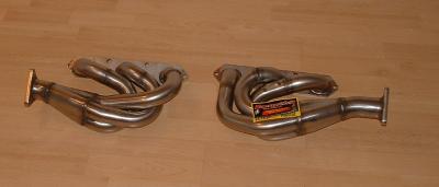

The swap hit the first snag when removing the 996 headers. Even with the heating of the bolts with a torch, 7 of the 12 exhaust manifold bolts broke, so now I will have to weld nuts onto the protruding studs and try and remove the remains of the bolts. Hopefully I won't have to resort to drilling too many of them out. I don't know what Porsche was thinking with steel bolts, threaded into aluminum heads, high heat and no anti-seize and obviously these have never been out since the engine was put together.

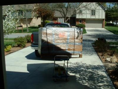

Picked up the motor at the shipping depot yesterday, so my swap is now officially underway.  If anyone is looking for a good 2.5L or TPC supercharger let me know.

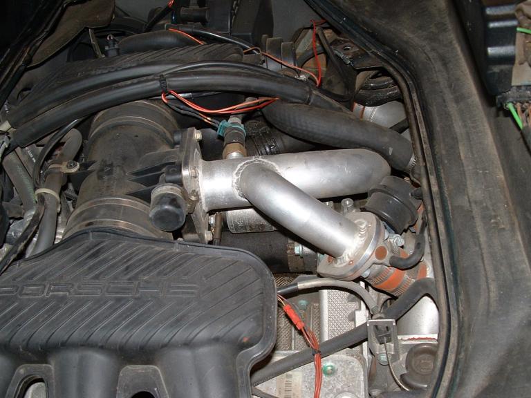

Please don't forget the pics of the S/C setup before you rip it out.
CW
What pics of the supercharger setup do you want to see? I took several pics of the wiring and installation that will be provided to the buyer of the setup.

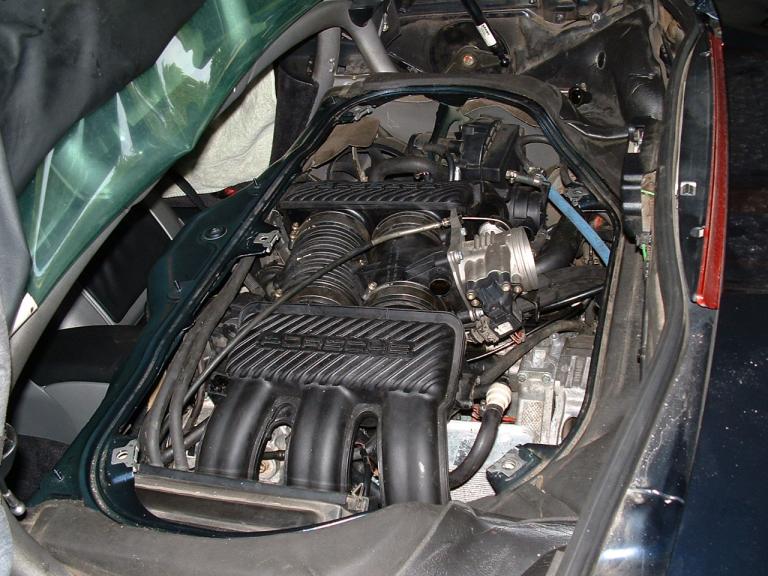

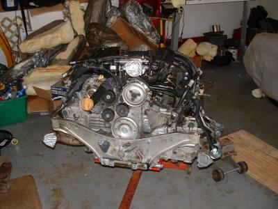

Here is a pic of the 3.4L in its new home
The DME is being reprogrammed today so hopefully it will be running soon.

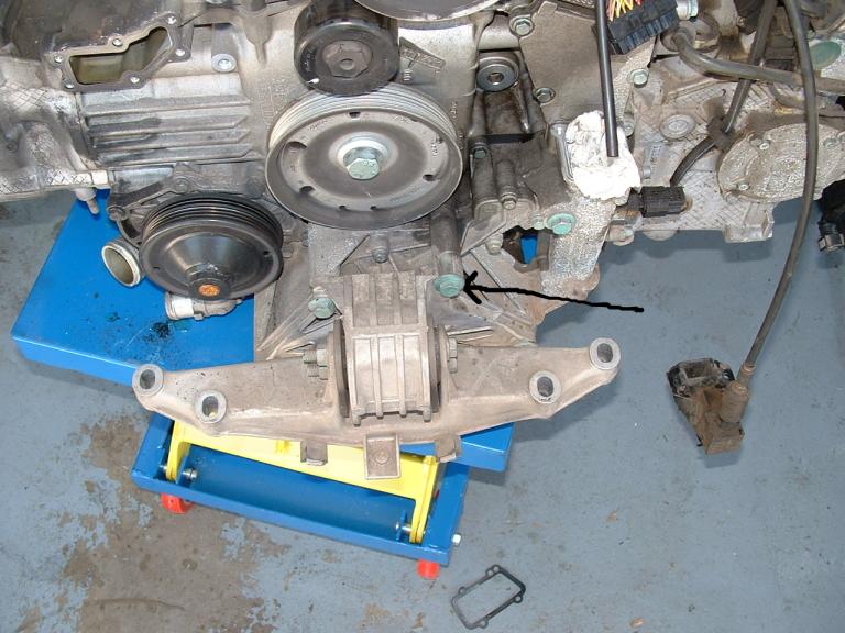

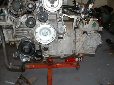

One of the interesting things I found during the swap had to deal with the motor mount and oil pump.
As shown here the Boxster mount bolts to the block and these bolts function also to secure the oil pump to the block (along with some other bolts)

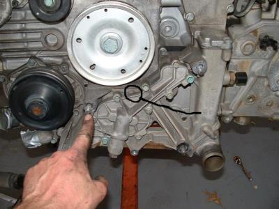

Now if we look at the bolt indicated by the arrow above, and then at the black circle in the pic below, this boss was not present on the 3.4L engine oil pump.

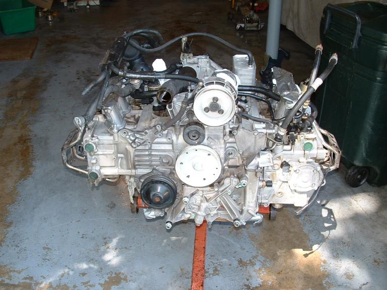

So instead of just swapping the cap and water outlet from the 2.5L oil pump housing (shown in the last picture (arrows), I had to remove the 2.5L oil pump and swap it onto the 3.4L block and then install the motor mount.
This turned out to be the only thing I encountered that I didn't expect. I have seen other 3.4L engines and the oil pumps seem to have the same boss that was on the 2.5L engine, so maybe I just got 'lucky'
