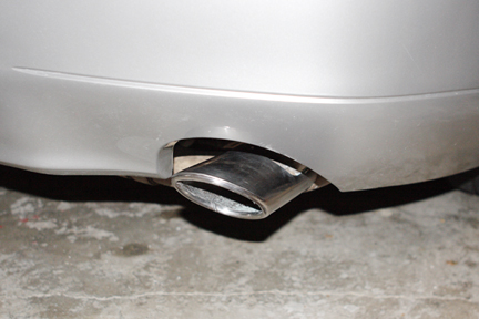

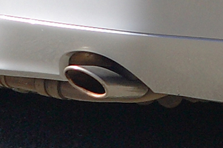

This is a summary of how to make your stainless steel exhaust tips look nice and shiny. Applicable cars: most 996, Boxsters, may be others. My exhaust tips were in a sad shape. I tried a variety of metal cleaners, but to no avail until "Oriental Express" provided the correct tip: you need to use some hard core polishing materials. I purchased a variety of 4 and 6" buffing wheels and several polishing compounds and an adapter to mount them on regular drill. I found the supplies made by Daco
Followed the instructions and they look great. Thanks for the "tip". Also, I have a heavy duty buffer with ten inch buffer wheels. It took me maybe ten minutes a side to buff. They look incredible. One tip to add; while you have the tips off, pry the flange that fits over the exhaust about an 1/8 inch wider with a large screw driver. It makes installation a breeze and closes quickly as you torque it down. Be mindful of the spacing between the body off the car and the tips, keeping it even all around the tip and note the depth of the tip as you cinch it into place. I polished mine one last time after installation with some metal polish for good measure. Entire project from start to finish, hands washed, took an hour. Thanks!
