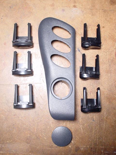

What year car?
Did it myself. Took about 1 hour total. This if for 99 and older with no PCM
You need the following part #s (number of item needed)
996 552 339 00 010 (1)
996 552 287 00 010 (1)
191 853 615 A (4)
900 143 076 02 (4)
996 552 351 00 (1)
'996 552 183 01 (2)
996 552 593 00 (2)
Some of the numbers were hard to read from the invocie but I think they are all correct
If you can get a copy of Technical information 911 (996) 8/00 6830, it will walk you directly thru the install.
Only tricky parts are 1. Send the AC lines to the left and then center, not to the right or they are too short and 2. the retaining frames are tough to hold in place. I used a small piece of tape finally and then screwed them in.
