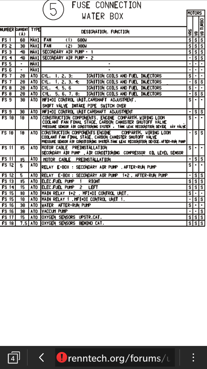

  1. Sorry my bad. You are correct 14 is left pump primary, 13 is right pump secondary.
    1 point
  2. Are you sure you don't have fuses mixed up? I'm currently on 1 pump in my CS with fuse 14 pulled and can hear the right side pump running/whinning when the car is on. I think Fuse #14 is for the driver side pump and #13 is the right pass side pump, but feel free to correct me If I'm wrong USA
