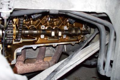

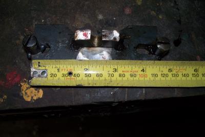

  1. Here's a pictures of the tool I used to hold cams in place. Approx 4.5" center to center. But I cut a slot in the steel and slid them in until they fit the cams and then welded in place. All done from inside car through engine access hole.
