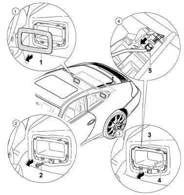

  22. Insert a screwdriver into the hole in the module and press it against the top edge of the pawl. Press the screwdriver to the right arrow A and hold it while pressing up in direction of arrow B. The roll-over protection system is released. To reset just push them back down until they latch.
