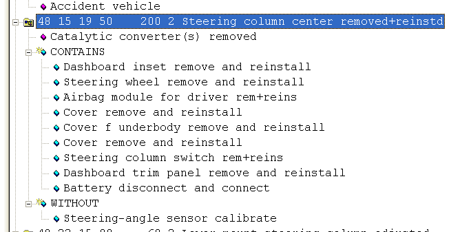

  6. I think you need to remove the complete steering shaft. Porsche book time for that is about two hours. Lots of work though - here is a summary...

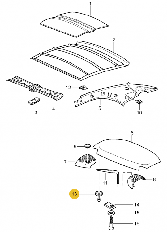

  16. Item 13?
