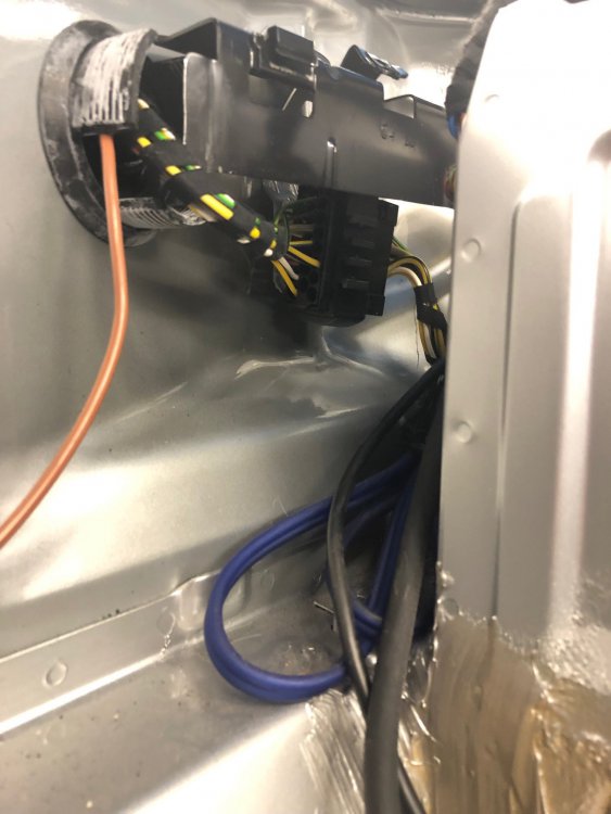

  3. Bumping an old thread! Where is the headlight level control unit located? I'm having issues with my litronic headlights stuck in the most dipped down position and need to locate this to troubleshoot the wiring. Lights attempt to flick up during key on headlight switch on. Motors can be heard moving but beam level of headlight doesn't change. I get all the faults through Durametric for 1:Engine path left 2:Engine path right 3:Axle-position sensor front 4:Axle-position sensor rear Here is the picture of the headlight level control unit in question. Does anyone know where this is found? Please Help!
