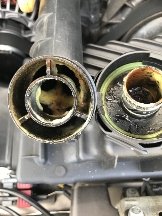

  1. Morning folks, I was able to drive the car a bit since my last post. I inspected the area around the battery for any coolant leaks. I found nothing. I also inspected the coolant reservoir and it's maintaining it's proper level. I also inspected the oil filler port but also smelled the port and only smell oil. I don't think I have a oil/coolant mix anymore. I plan to replace the heat exchanger this week hopefully taking care of the awful coolant smell in the cabin. Again many thanks to you gents helping me sort this out.

  4. Hi Joe, thank you for getting back to me and for your time. The car did sit for 2 weeks until I was able to change out my alternator. I've driven the car quite a bit since. The car sat running at idle 3 days ago while I was charging a battery for my drone. I just looked at the coolant level. It has not dropped at all. You or someone else mentioned the heater core too. That I may have a pin hole leak? I have a new heater core in my garage but haven't replaced it yet. The oil was changed at 72,683 or 2500 miles ago. The car had 68,500 miles when I bought It. It now has 75,300 miles. I have never had to add any oil since I bought it. The oil filler cap and the stronger smell of coolant is what got me worried. Again, thank you for hashing this out with me.
  5. Morning all, Short history. 2004 C4S Cab. I bought the car one year ago from a Porsche dealer. One month later I smelled antifreeze inside the cab with the heat on. Another Porsche dealer garage pressurized the system for an hour showing no leaks. The odor is still present. I took it to a private Porsche specialist. After three weeks, pressurizing the system, changing the coolant, changing the oil and boro-scoping the cylinders, he found no leaks. The odor is still present and getting stronger. I found yesterday my oil was one quart low. I added a quart and found this. See the photo. I think I now have coolant mixing with oil. I'm afraid to drive it but want other opinions before I start scheduling a mechanic to look at it or go back to the dealer where I bought it. Thank you.
