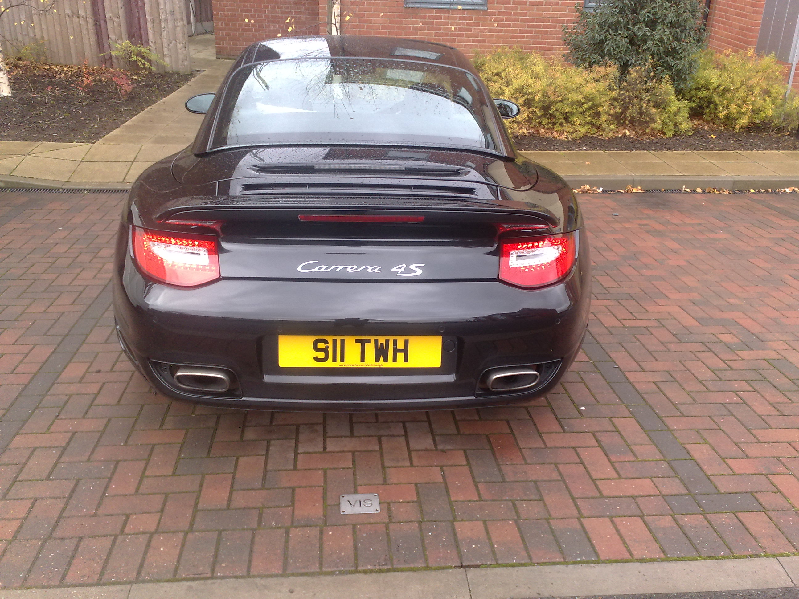

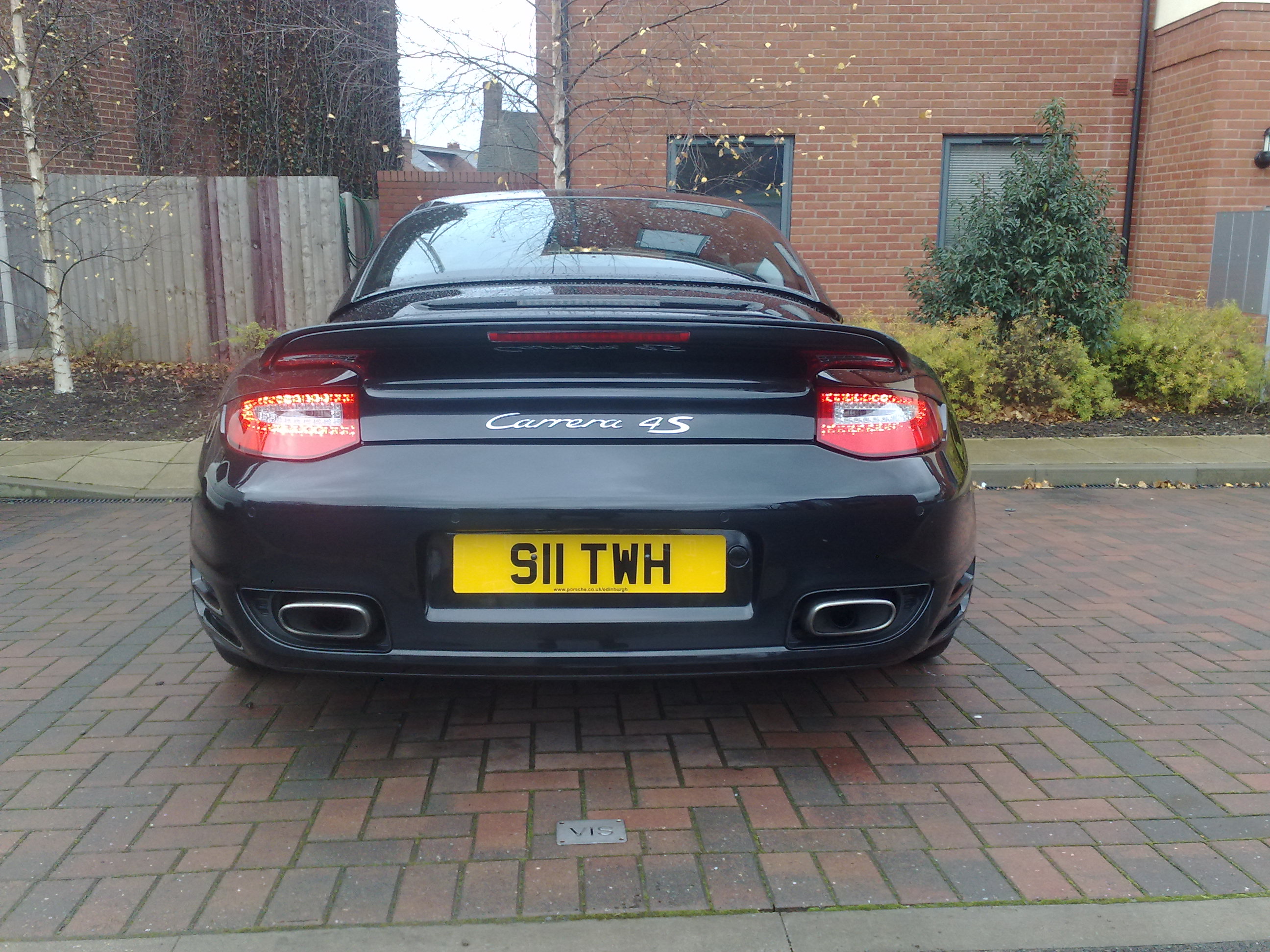

  9. Hi there, Front bumper from ebay £80, plus £150 to paint, led drl £140 per side new, gen2 mini loom £25 per side new, grilles £25 per side new, headlight washers, £50 per side new, center duct £35 new, rad ducts £60 per side new, plus £200 to programme control unit and have it hacked, reprogramme and hack done by an official porsche centre mechanic, just under £1100 in total, Rear was £350 per light, turbo bumper modded with top half of a damaged gen2 bumper, bumper £40 ebay, paint & plastic weld £400, reprogramme was in with front lights, didnt need to change rear control unit as my car is a 2007 my so £1140 all in, total cost was £2250 but was well worth it as car looks new, if you go down the route of new bumpers your looking £500 per bumper new, available from porscheshop.com, at the time i did mine the turbo facelift hadnt been released so as i had a turbo bumper already fitted it was cheaper to mod, the guy who did the lights is the only guy in the uk who can do the hack, ive just sold 2 front drls on ebay 2day for £250, there is currently an led rear light listed, as i said well worth it regards Tim Hi Tim - congrats! I'm getting ready for the rear and front conversion of my '06 C2, couple of questions in regards to the front: was going to order the factory Gen-2 bumper cover, center duct, R+L grilles, rad. ducts, washers, - does the new bumper cover just bolt on like the Gen-1, or are modifications necessary? To wire the new LED combo-lights: - do I need a control modul to power the lights? - If yes, do you have the parts-# ? is it 997 618 511 01 ??? - where in the front trunk do I have to look ? - you mention R+L mini loom - can you explain some more how you did it and do you have the parts-# ? THANKS for your help! ralf Hi ralf, you do need a new front control unit which needs some pins removing but i do not know how to do this as the guy who did mine for me kept it a secret as he is the only guy in the uk who can do it properly , and i guess knowledge is money, the module is on the drivers side front on a rhd car, the mini loom is the gen2 loom that connects to the gen2 lights, about 12 inches long, this needs to be spliced in to your existing loom, again i do not know the proceedure, will try and locate part numbers for you , if you were in the uk i could have got work done for you, regards Tim

  11. Hi there, Front bumper from ebay £80, plus £150 to paint, led drl £140 per side new, gen2 mini loom £25 per side new, grilles £25 per side new, headlight washers, £50 per side new, center duct £35 new, rad ducts £60 per side new, plus £200 to programme control unit and have it hacked, reprogramme and hack done by an official porsche centre mechanic, just under £1100 in total, Rear was £350 per light, turbo bumper modded with top half of a damaged gen2 bumper, bumper £40 ebay, paint & plastic weld £400, reprogramme was in with front lights, didnt need to change rear control unit as my car is a 2007 my so £1140 all in, total cost was £2250 but was well worth it as car looks new, if you go down the route of new bumpers your looking £500 per bumper new, available from porscheshop.com, at the time i did mine the turbo facelift hadnt been released so as i had a turbo bumper already fitted it was cheaper to mod, the guy who did the lights is the only guy in the uk who can do the hack, ive just sold 2 front drls on ebay 2day for £250, there is currently an led rear light listed, as i said well worth it regards Tim

  13. Hi paul, thanks for diagram but need diagram from 997-1 and 997-2 and hopefully some instructions on what to cut and what to join, surely somebody else must have done this conversion, i hope so regards Tim Hi guys just a quick note to say i have finished my front end conversion to gen2 and it looks awsome. as my car is a 4s the front grilles(997 505 563/4 05 9b1) are titanium and this looks really good against basalt black. A mechanic from an OPC converted my loom for me and charged £250 ($410), it took him about 20 minutes to do, when you turn ignition on the front leds come on, then when you turn lights on they dim , however if you want them really bright again just put on the foglight switch. only problems i had were the headlight washer units (997 628 163 01)are different on a gen2 and the mk1's cant be retro fitted, and also the centre duct surround (997 505 541 03 01c) also needs an additional air deflector to deflect the air to your rads, porsche part is called air routing (997 575 141 04 1c), even the dealer didnt know i had to have this, all in all well worth the hassle, car is going in next week for the rears to be done which as you guys know is really straightforward, well at long last its done , see attatched foto. Regards 997t Just a quick update to the post, new led rears now fitted. i also have a turbo bootlid fitted and a turbo bumper, car looks dope (awsome) looks £85000 worth with mods and £100 996 hardtop from ebay.

  21. Hi, the gen2 turbo bumber is not yet available as ive been waiting to order it myself. im just about to upgrade my front and rear lights, i already have a turbo bumper fitted to the rear of my c4s cab and it looks so much more manly than the original, i also had to have my rear exhaust tips altered as they sit higher up on a turbo, a local bodyshop is going to rea-shape around the new led lights for me to get that factory finish, the gen2 turbo bumper is exactly the same as the gen1 apart from the light apetures, i have a complete gen2 front bumper, just waiting to book in to the OPC to get the new control units coded (front and rear), ps, just for the record the gen2 upgrade looks awsome, if you keep your original parts then when you sell the car you can put back to standard, anyone who says its a waste of time doing the conversion must in my opinion be nuts, or jealous, gen2 looks a million $$$$$$$, always hated the standard front on mine anyway. Go for it, you know it makes sense Regards Tim
