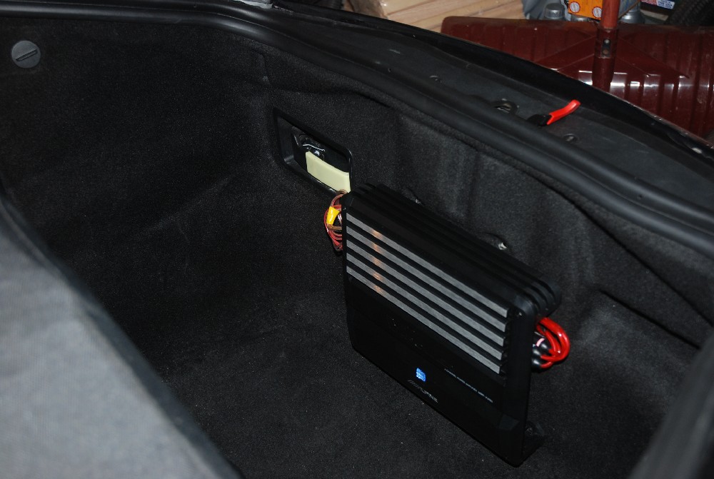

  11. Finally decided to go by the front. Did built and rivet two steel brackets to offset the amplifier the same way the lock is. Looks nice, take not much space. Thierry

  20. I'm personally planning to screw it on the lower left side when facing the spare tire. Is there any problem to use self tapping screws and screw the amplifier in the steel wall of the car? Do you have other options? Thierry
