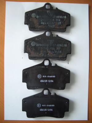

  13. I am sure that I have posted photos on this site showing that Brembo are just rebadged Textars. I can't find them so here you are:
