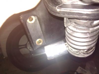

  21. Yup cut the old bellows + 11mm socket is a great OEM clamp holder,,,
