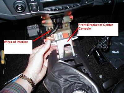

Thanks to Rockitman for posting his instructions with pictures. I have nearly completed my console delete modification on my 98 Boxster. However, while removing the front mounting bracket in the attached picture, the thin bundle of wires (also indicated in one of Rockitman's pictures attached here) came loose. Does anyone know what purpose those wires might serve? I can't see anywhere where they might connect. And if they're for some option I don't have, I'm concerned about rattles as those wires and the plug they join at is just flopping around loose under my console delete kit. Where is this small bundle of wires supposed to go? Please help, I'm almost done with this mod!
