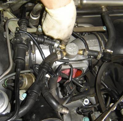

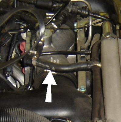

  2. Let me be clear: This is the hose we are looking for correct? (see arrow) B
  3. I *thought* it would show it in the tank diagram but it does not. That particular hose helps pull a vacuum on the oil tank and heads. The check valve is to keep boost from pressurizing the tank and heads. B
