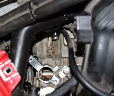

At one time I had the engine compartment open revving slowly up to about 4,000rpm and this flap did operate at about 3,000, although there was no vibration. Could definitely hear something click and indeet you can see the stud on top rotate. There was a lot of oil when cleaning it but did not notice grit. But since I operated it about 5 times plus cleaned the linkage outside with a toothbrush this could be it. So there is something else relatively simple for folks to try. Well, the vibration came back. If Renntech believes this is a misleading post and thread, please remove it in its entirety so people will not think this will solve their vibration problem. It is a fact that the vibration was gone for about 4 days and over 100 miles after this work. I have another question which I will post as a new item. -

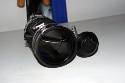

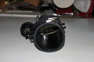

Now there is a possibility, I made sure that was clean and functioned fully, operating the linkage attached to ther vacuum canister. I assume you are talking about the (horizontal duct forward of the throttle body) this thing: Silly for Porsche Service to not even try. My explanation is quite elaborate but it is because I spent hours making sure they understood all the conditions precedent to the vibration. Thanks for the evaluation. -

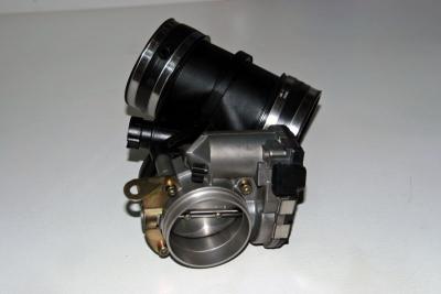

Hey, George. I participated in the thread you reference. Had NO vibration when stationary or before warming up to 185 degrees. You may be right so here is what I did: 1. Read and cleared misfire faults cyl 2,4,5. 2. Removed and cleaned (just wiped off oil, used no cleaners) throttle/manifold section and forward manifold section taking care to see that connectors and vacuum tubes had been secure before removing. 3. Removed old AOS. 4. Cleaned MAF. It's connector was secure and clean when removed. 5. Replaced K&N air filter with OEM filter. Used since June 2006 and cleaned annually. Decided to not use based on posts I have seen about K&N not keeping particulate out. Note vibration predated 2006 use of this filter. 6. Cleaned a little oil out of intake air duct that had dripped into it. 7. Installed throttle and manifold section with precise care for alignment and reconnecting of everything. 8. Cranked and ran, cleared other codes for precat O2 sensor and CEL not being present. 9. Been to work and back 3 days, no codes, no vibration. So what could it have been? Alan -

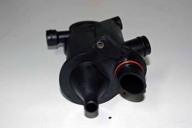

Great job! Did you find it a difficult repair? For $90 this must be a DIY correct? Yes, DIY. Took about 3 hours to remove the top manifold sections and throttle and clean all the oil out, but otherwise it was not bad. Anything in the Boxster engine compartment is tight, but the AOS was just a little tedious, that is all. The AOS cost anout $78 and the bottom hose was $12, and that is at the local dealer. I posted a fix and some photos just before this post which goes into a little more detail, but it is mostly about the AOS having blown. If it was just replacing the AOS and not all the clleaning it would be considered almost easy in my mind. -
I just replaced my Boxster's AOS on a 2003 with a 2.7L engine, 65,000 miles, 5 speed manual transmission. An unexpected byproduct is that an engine vibration at about 3200 rpm's that Porsche said was normal is completely gone. I also cleaned the MAF but surely that was not the fix. If you have a vibration that occurs after warm up when accelerating thru this rpm, driving on the highway at this rpm, and more pronounced decelerating in gear thru this rpm, and you have not replaced your AOS, you might just want to try this. I would welcome any dissertation anyone out there may have as to why this may be so, although I have my theory and told Porsche that in 2004. Have at it.
Last friday my AOS blew completely. Thanks to this forum I was able to come back from the brink of the abyss and all is well. Most of the AOS posts show or describe a unit that bolts to the side of the engine and has a bellows on the bottom. For the 2003 the unit bolts down directly onto the variocam area without bellows and has an L shaped tube that fits onto the side of the engine. I went with the cut the old hose and replace it route using the hose clamp for the new hose connection to the side of the engine. The newest revision number is .01 and cost about $78. I had the .00 on my 2003. Please be careful with the vacuum tubes if you choose to remove and clean the horizontal manifold sections and throttle. I strongly recommend this if you had a thick white smoke, you will surely have standing oil in the manifold sections. I was about a half quart low after this trial. Also note that I got a lot of fault codes upon starting after cleaning. I also got a lot of white smoke upon restart for 5 minutes or more, but it did not foul or cause additional codes. All fault codes cleared out and everything is lovely. I have a Durametric diagnostic tool. I offer photos for your edification. There are more and I will answer any questions you may have.
