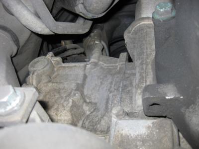

  1. Hey RFM thanks for the reply! The picture in this thread is the US passenger side, water pump side of the motor, looking up from the bottom then a shot from above. In my other thread it shows the tranny side of the same head and you said it is incorrect, and it should be on the water pump side. Which one is it? It is bank 2 which I know is the passenger side on the US car. I can not see any sensors on the tranny side of the head. I saw the picture of the Bank 1 sensor in the other thread which is on the tranny side so I thought the bank 2 sensor would be on the water pump side. This is soooooo confusing! Is the sensor under that coolant hose in the 2nd picture? thanks again for the help!
  2. right below this coolant hose?? and is this the right sensor???
  3. I have a MY99 996. The check engine light came on for my bank 2 cam sensor. I have the new sensor here but cant find the sensor on the engine. I saw a pic of the driver side (bank 1) sensor but not the passenger side. is this the spot? it is the back of the head, closest to the bumper. Thanks in advance everyone!
  4. I have been trying to find this for hours... can you guys help me out a little more? I am under the car looking at the tranny side of the passenger bank. i can see the green cam caps on the back of the head and there are no sensors around. I attached a picture can you guys tell me if this is the right area? maybe circle where the sensor is? Thanks in advance!
