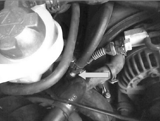

  14. Thanks for the quick reply, Loren. Glad I didn't try to "fix" the connection. That could have been a mess. I'll keep an eye on the coolant level. I'm hoping that the "leak" was just the loose cap, but that would not explain why the coolant was low in the first place.
  15. I need some help checking a potential problem with my 2000 C4 Cab. I noticed that one of the coolant lines doesn't seem to be seated fully on the white connector indicated with the arrow on the attached picture. It doesn't appear that anything is or has been leaking from this connection. I don't know if there is supposed to be this gap, so I'd appreciate if someone could take a look at their car to see if your coolant hose is connected in the same way. I'd hate to loosen and reconnect a hose that already is properly connected. Thanks for your help. Background: Last weekend I noticed the coolant level was below the min line. I haven't had any problems with high temps, but decided to add a few cups of dionized water to get it mid-way between the min and max lines. Unfortunately, I did not screw the cap on tight enough and left a puddle of coolant behind my left wheel after a 20 minute drive. I topped up to just below the max line with dionized water. Next morning, I notice the water is below the min line, so I add a bit more (now having used a total of about 1/2 - 3/4 gallon). I haven't driven the car again, but the water is again just (barely) below the min line. I don't see any signs of coolant leaking. I'm not sure if I have the updated coolant expansion tank, but the cap number ends in 01, so I think the cap is the "newer" one.
