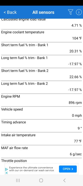

  1. Ok smoke tested through the tee on the aos top, no smoke noted leaking. Aos bottom hose was alittle rattling near the connection pushed in. Smoke was in the intake to the filter but none under oil fill cap I guess that's separate . Data recorded fuel trim short term positive 14-16. Long term -3.1 , symtoms slight stumble on cold start no codes A bit of oil on the right rear wheel well frame.

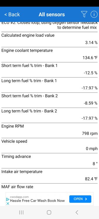

  2. 00 boxster s with 91k fuel trims go to zero when I give it gas. Runs good already cleaned throttle body. Haven't attempted to smoke test anything. This has been an issue for awhile so nothing I just did. Maybe some obvious places to check. Thanks
  3. i got a bremi maf this time seems to work fine porsche seems to be double displacement for maf idle 3.2 x2 = 6. fuel trims around 3 -4 now. there is a little hickup when the idle kicks down during warm-up.
  4. Today I got bad idle on a cold start up practically stalling and like a mini backfire. So I checked all the clamps . Has alot of power but bucks and notchy in gear at times. Has original fuel filter. So not fixed by replacing maf no codes yet.

  7. My car has about 89k miles on 2000 S. cleaned maf went away came right back ordered a new maf.

  10. It was an air leak on tb connections! whew. Sent from my SM-G950U using Tapatalk
