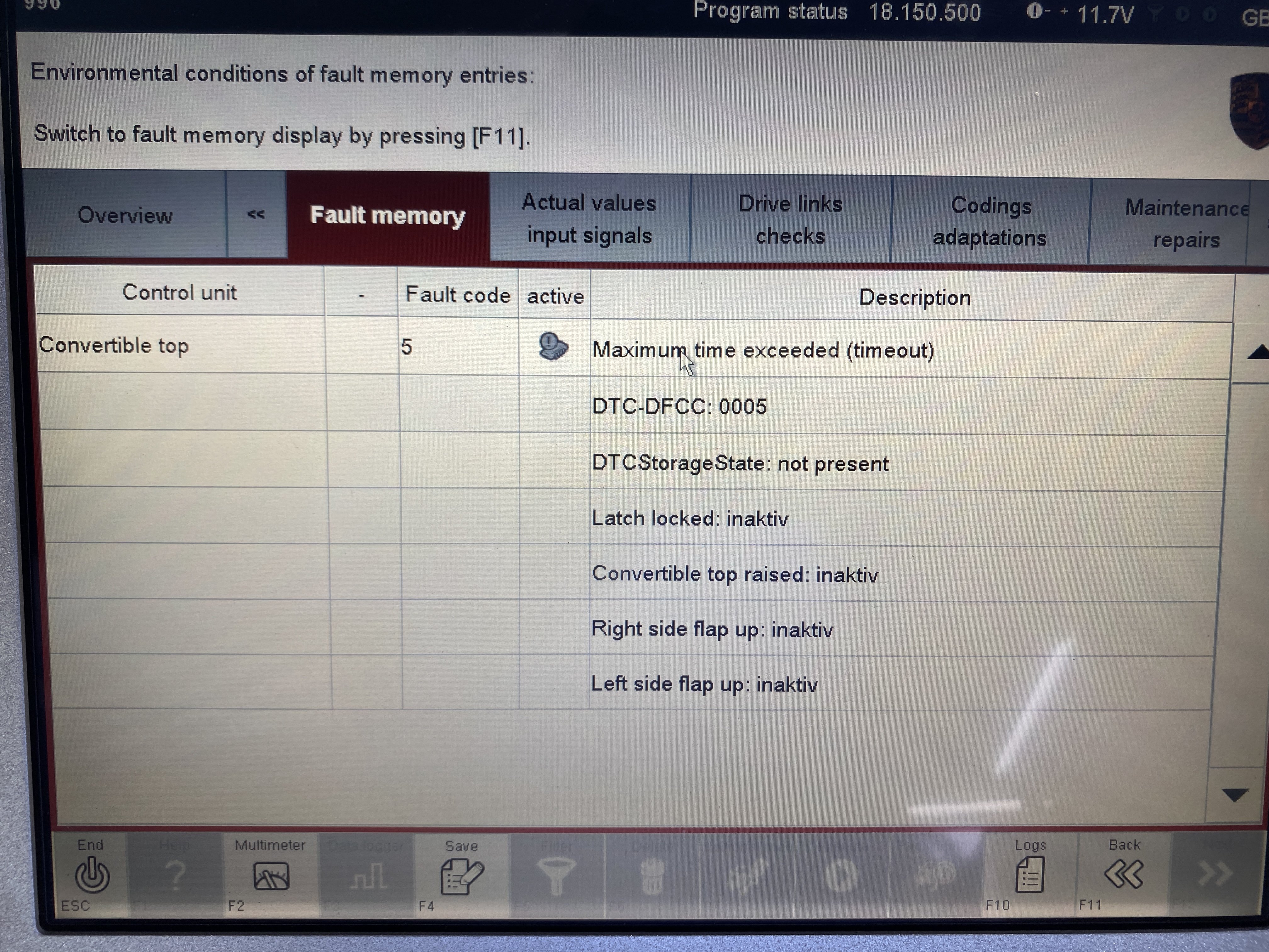

  1. I will give it another try... I've already rebuilt the top latch that was misaligned by 3 notch in the positioning gear, I will move it of another notch to try to match the original synch. If that works I'll have to deal with the dead (inaktiv!) side flaps, although they are not as expensive as the rest.

  3. Thanks Loren, I tried several times but it always get stuck at the same position, with the half top portion vertical. The screenshot above is what is left in the fault memory...
  4. I purchased the repair kit for the top tonneau clamshell lid motor 996-561-673-00. Replaced the shaft and set the potentiometer at 6.2 K Ohms before re-installing. Now I have other problems:

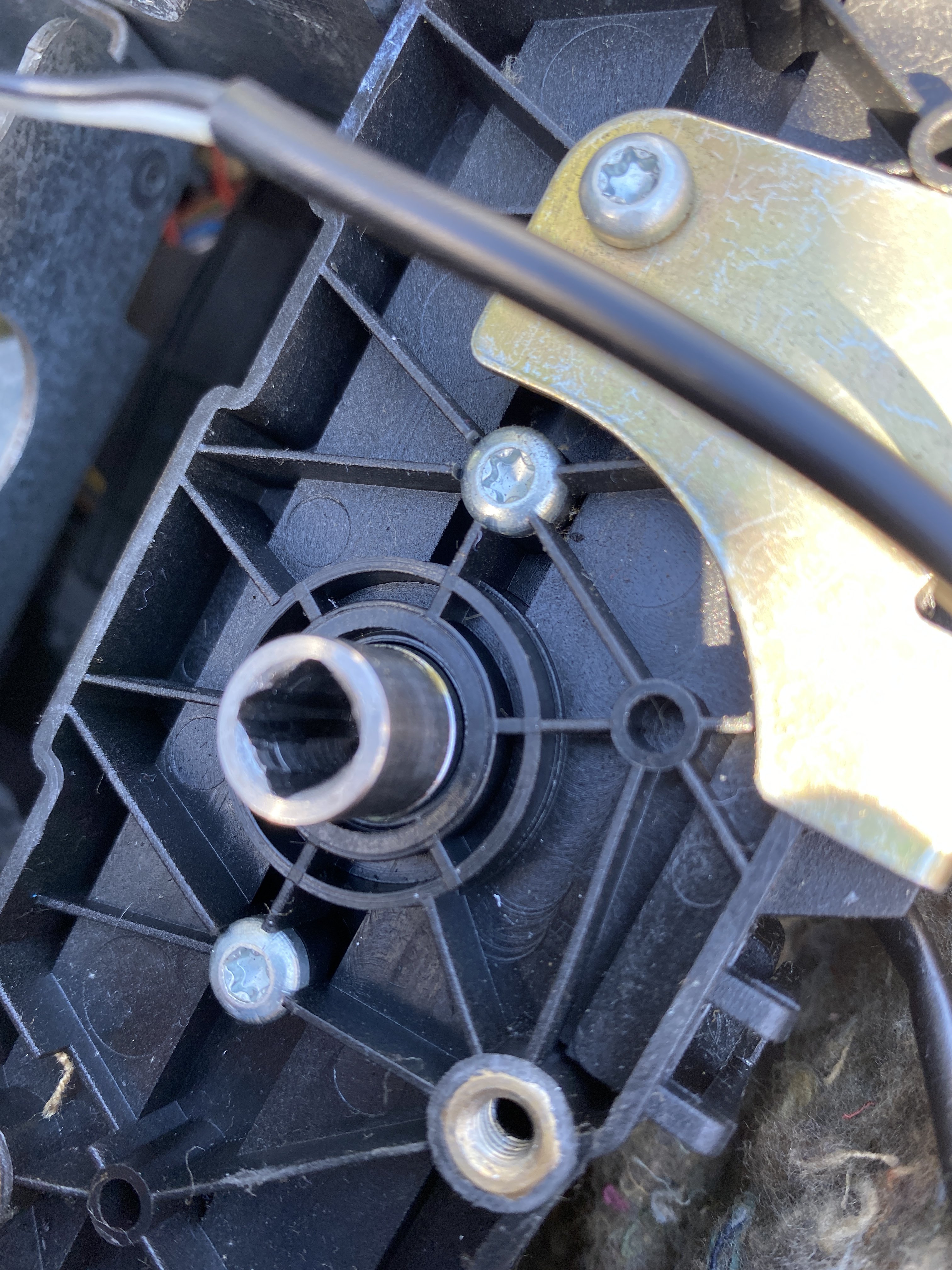

  5. I cannot figure out how the groove part could get traction over the rounded metal surface, is there some kind of friction required? Shall I overtight the motor to the black assembly?
  6. Hi folks, Can someone please explain to me how the top tonneau clamshell lid motor (Fig.1) engages with the unlatching cords mechanism (Fig.3)? I already changed two motors, replaced the inner rod with the plastic potentiometer gear and I still can't properly operate the clamshell cover. If you look at the motor (Fig.2), only the outer ring with the small grooves will rotate but it will not engage with the metal part of the unlatching mechanism (Fig.3) Am I missing something? I can ear the motor working when I operate the top but it doesn't unlatch or move if I don't do it manually. I only have a Time Out error on PIWIS and cannot complete the calibration, or even worse one time the soft top tried to fold over the closed clamshell cover... Thanks for your help!

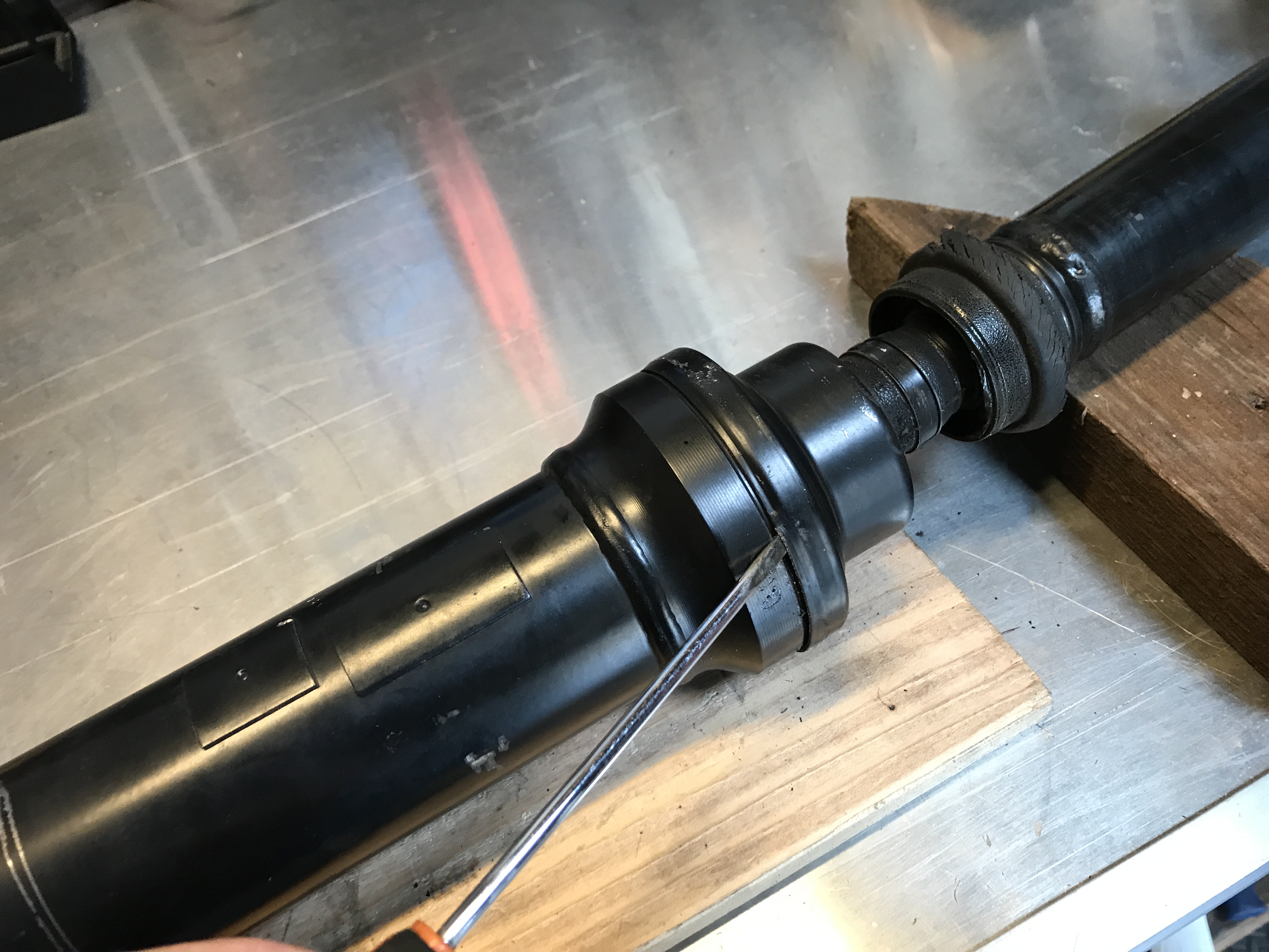

  10. Came back to SJ with the aftermarket shaft, tested 'till 95 mph no vibrations whatsoever.. Now let's have some fun and try to fix that under engineered shaft...
  11. Wow, that's an awesome fix! Thanks! BTW I ended up getting the cheap cardan from Amazon, it will be installed tomorrow by a local shop. I'll tie up the old one on my roof and make it back to San Jose and if the new part gives me any problem, well it's Amazon Prime... At least I'll have the option to fix (or improve) the old one on my bench with Jimi's trick!

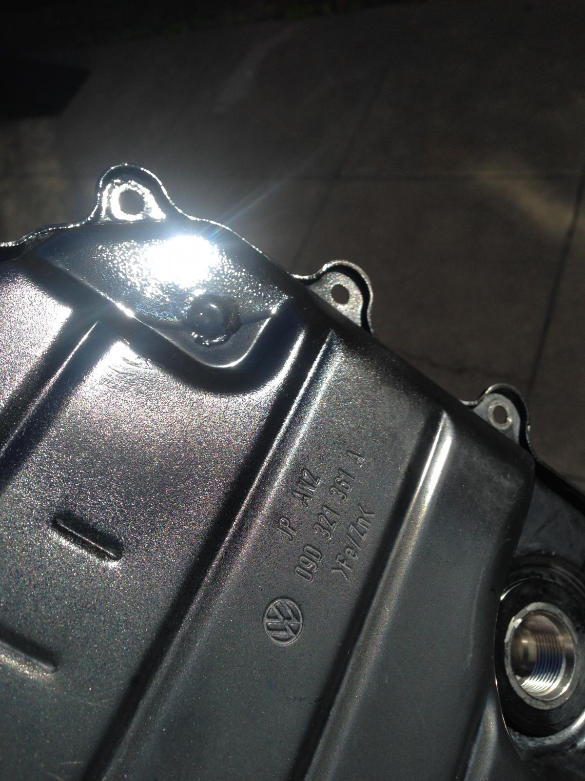

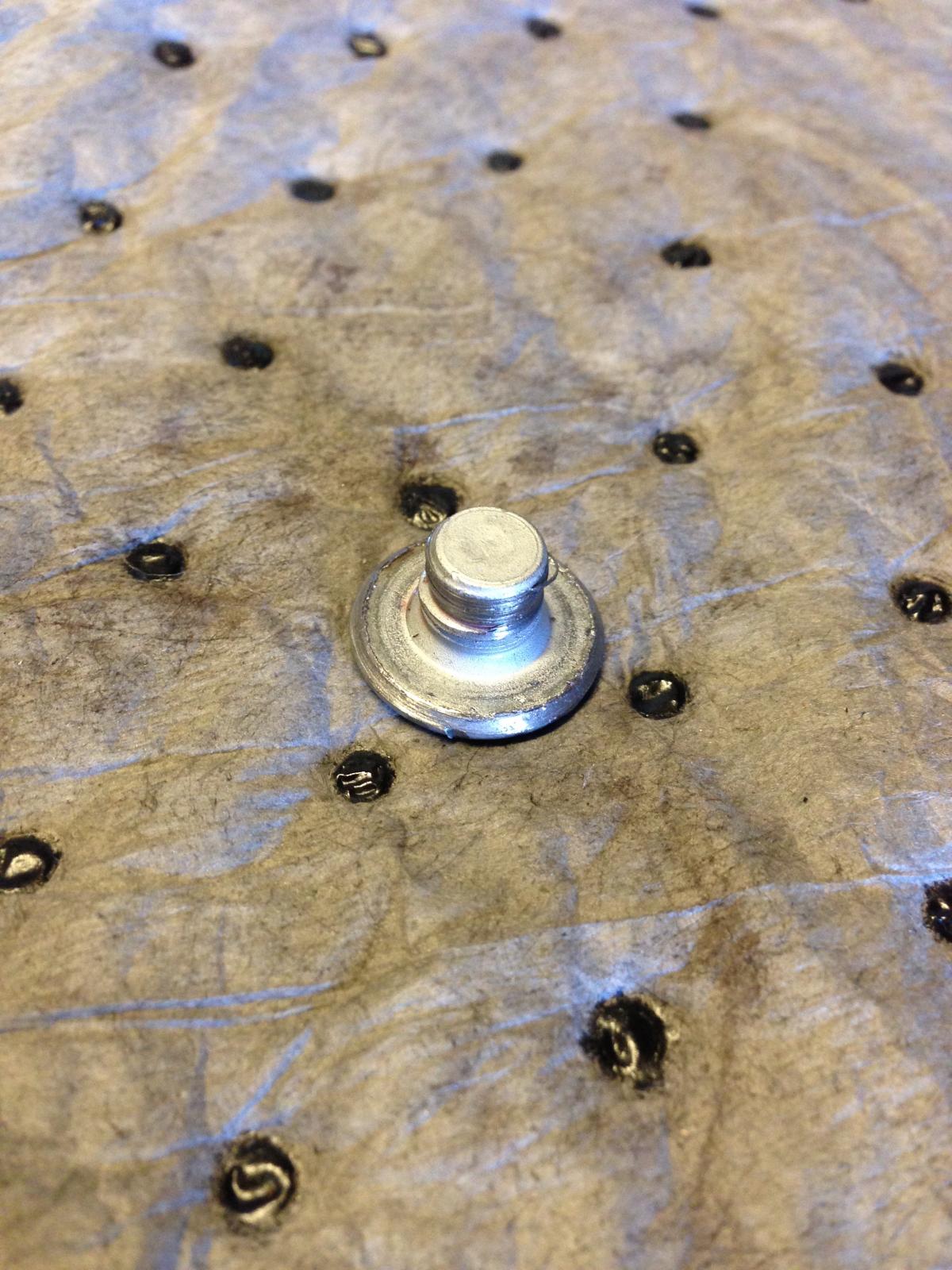

  16. I just got the car and I'll keep it at least for the next two, three years. Now I have plenty of time to find a new or used oil pan without having the problem of a dripping oil plug!

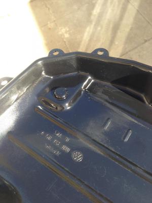

  18. How to fix a stripped drain plug on the Tiptronic transmission? I was trying to find a solution when I realized "do I really need a drain plug?" If the Tiptronic was intended to never have an oil change why there is a drain plug? Anyway... yes, we do need to change the oil and the filter! at least very 80K-90K miles! Just a couple tips... 1) the drain plug will easily strip, 2) Use the Toyota type IV OIL @ 7$ per quarter The tranny speak Japanese so don't waste your money at the Porsche dealer.. And finally, you need to change the filter so the oil pan will be removed anyway and the oil with it That's why I decided to not spend 180$ for a new oil pan.
  19. Update, this morning I pumped inside the tranny at least one more quarter of oil, then I left the motor running until the oil was at 40 degree and letting it dripping out before torquening the filling plug. Unfortunately I think that I stripped the drain plug, my dynamometric wrench wasn't working, I was waiting to ear the click forcing the bolt and now the bolt keep turning. The car runs fine, I'll wait a couple days to see if it's dripping from the drain plug. If that would be the case, what you suggest?
