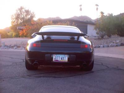

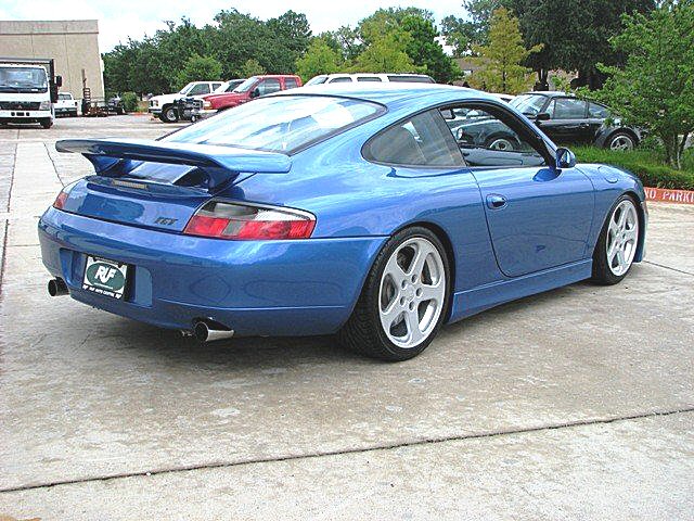

  21. RUF wing and decklid can be adjusted for downforce by using angle of attack on the wing, but not height.
  22. What kind of wing is that? RUF Deck Lid and Wing
