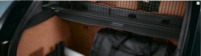

  25. I was looking at a pic from Porsche catalog and it looked like they had both the mesh divider/curtain and the cargo cover installed at the same time, I didn't think this was possible. Has anyone been able to do this?
