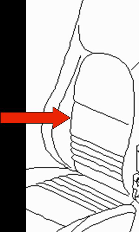

  16. Thanks Kim, I was wondering about that. I did some probing last night and found some other previous posts under "lumbar". One recommended a clean solution. Reach your fingers inbetween the seatback and the side bolster where the arrow points and pull carefully. You will notice the seatback is only attached on the top and bottom. Now you can see into the back of the seat area, limited access. Insert some "lumbar" support as needed to satisfy your back. A piece of foam could work, and it will be hidden from view. When you reach in there, see if you can feel or see anything where the lumbar support is supposed to be. I did not see or feel anything myself.

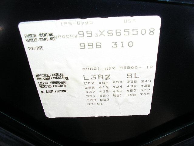

  17. David, mine looks exactly like yours. I am not sure know exactly what the 537option is. If it is lumbar support, why isn't there an adjustment knob or button? The owners manual shows a button for lumbar support adjustment. So what is the purpose of the option without the ability to adjust? I got to pick up some parts at the dealer later this week, will see if they can shine a light on the subject. Hopefully I won't get the same answer you got at your dealer! Izzy
  18. Loren, If I understand correctly, items 1 and 8 are needed to be added to use the lumbar? What about 16, the actual adjustment knob? Thank you Izzy

  20. This is a good question. The option 537 if you look at the Online Docs Menu, Option Codes Lookup, it shows option 537. The description is "SEATING POSITION CONTROL FOR CONFORT SEAT, LEFT" This is a good question. The option 537 if you look at the Online Docs Menu, Option Codes Lookup, it shows option 537. The description is "SEATING POSITION CONTROL FOR CONFORT SEAT, LEFT" I have it, but never bothered to check to see what the heck it is as an option. Let me know what you find out, can benefit more of us. Izzy sticker_in_trunk.bmp
