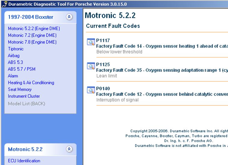

  14. I need help see attachement :( again troubles they alreayd replaced my MAF ..

  22. Guys this is the error Motronic 5.2.2 Current Porsche fault code 35 ? Hallo, If the CEL is not blinking you are ok. When you get the code(s) report back and we'll see what the issue is.
  23. Hi all, I have a my1997 boxter LHD with 32000 Miles, my oilfill tube was cracked and porsche replaced this under warrenty, after about 250Miles my CEL was burning, i could see on the PWIS tool of the dealer that one 02 sensor was not working at all bank 2 after cat , so porsche replaced this ($600), i drove 150 miles and again the CEL, went back again and they did a full diagnose MAF was ok, power was ok, on my car but couldnt find any issue although my car was now reporting both bank cylinder 1-3 and 4 to 6 faulty or near limit, they resetted this with a pull of the accuc onnector ...today again my CEL burned, i have resetted this by pulling the accu cable and it was driving a little rough but after 50 miles seems ok now..does anyone have any idea what this fault can be? Can it hurt to leave this as i am afraid to go back to the dealer as they only want to replace parts like my o2 sensor which i think wasn't even faulty now... I have bought the durametric software and cable for $150 on ebay so i am able to read out my car soon but any help would very welcome what i can check upfront before i go back to the (st)(d)ealer...... Any advice what to do is welcome, i am a newbie in this so please be gentle...i have not changed anything on my car like airfilters etc, and its just out of warrenty ..
