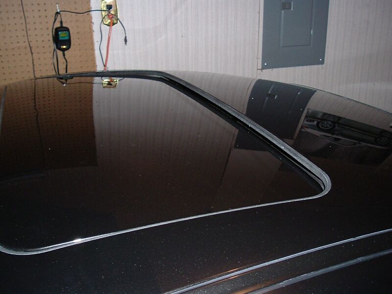

  18. For some strange reason my sunroof on my 996TT won't automatically close to the correct position. It constantly settles at a down angle (as seen in the pic) instead of being flush with the roof like it should be. All fuses are good...and I can make it flush with the roof by manipulating the sunroof button...but it won't do it on its own anymore. Anyone have any idea what could be causing this? TIA.
