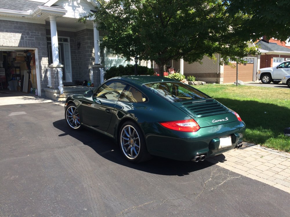

  1. I love my PRG. Discreet, classy, and different. The colour also changes quite a bit with lighting and angle - it can look dark green and even almost turquoise depending on the light. Only downside is that as with most darker colours, it shows scratches and swirls. I had the car paint corrected last spring, and the paint now looks WET and DEEP.
